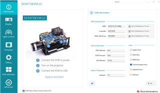

  • Hello Weike,
    Please share an image of the 'Information' tab after you perform a 'Get'. I'd like to confirm we're all up-to-date with everything.
    Thank you!
    Aaron
  • Hello Aaron,
    Here's the image I get:
    Weike
  • Hello Weike,
    Could you please update to the latest firmware using the Firmware Selector Tool. If you select the DLPC3479 the EVM default selections will autofill.
    Then you can use the GUI tab for 'Firmware' to 'Flash firmware' and update to the latest.
    It is highly likely that our last update will fix this as there was an issue seen with a desync of the Primary and Secondary controllers.
    Let me know if this persists, if not please accept as resolved.
    Aaron
