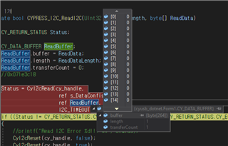

If you look at the dlpc347x_samples.c code of dlpc-api 1.10, there is a function called CYPRESS_I2C_ReadI2C, and when this function is converted to C#, it is as follows.
private bool CYPRESS_I2C_ReadI2C(UInt32 ReadDataLength, byte[] ReadData)
CY_RETURN_STATUS Status;
CY_DATA_BUFFER ReadBuffer;
ReadBuffer.buffer = ReadData;
ReadBuffer.length = ReadDataLength;
ReadBuffer.transferCount = 0;
//0x071e3c18
Status = CyI2cRead(cy_handle,
ref s_DataConfig,
ref ReadBuffer,
I2C_TIMEOUT_MILLISECONDS);
if ((Status != CY_RETURN_STATUS.CY_SUCCESS) && (Status != CY_RETURN_STATUS.CY_ERROR_IO_TIMEOUT))
//printf("Read I2C Error %d!!! \n", Status);
CyI2cReset(cy_handle, false);
CyI2cReset(cy_handle, true);
return false;
return true;
CY_DATA_BUFFER was declared as follows:
struct CY_DATA_BUFFER
public byte[] buffer; // Pointer to the buffer from where the data is read/written
public uint length; // Length of the buffer
public uint transferCount; // Number of bytes actually read/written

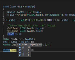

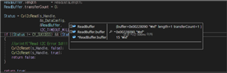

In the step of getting the initial device ID, the sample code in C can confirm that the value 15 is entered into the buffer.
However, in the C# code, data is not loaded into the buffer.
There is no data in the buffer.
Is there a problem with the data type of the CY_DATA_BUFFER configuration format? or,

    DLPC34XX_ReadControllerDeviceId function confirmed that it read 1 data successfully.
    However, in the case of DLPC34XX_ReadInputImageSize,
    in C API Example, after DLPC34XX_ReadInputImageSize function, ReadBuffer.buffer fill with 4byte data.
    This is because it sent a length of 4 bytes.
    but in C#, only gets 1 data.
    Since transferCount is 4, I confirmed that 4 data were read.
    In C#, what exactly is the correct Read and Write buffer data type to use?
    if you want to get my c# Project File, I will send to you. I just make a DLCP_API 1.10 to C# code.
    Thanks.

  • Hello Kirthi,
    public unsafe string DLPC34XX_ReadDmdDeviceId()
    ENUM.DLPC34XX_DmdDataSelection DmdDataSelection = ENUM.DLPC34XX_DmdDataSelection.DLPC34XX_DDS_DMD_DEVICE_ID;
    UInt32 Status = 0;
    string DMDID = "";
    DLPC_COMMON_ClearWriteBuffer();
    DLPC_COMMON_ClearReadBuffer();
    DLPC_COMMON_PackOpcode(1, 0xD5);
    DLPC_COMMON_PackBytes((byte*)&DmdDataSelection, 1);
    DLPC_COMMON_SetCommandDestination(0);
    ushort WriteLength = 1;
    ushort ReadLength = 4;
    Status = DLPC_COMMON_Read(WriteLength, GLOBAL.byte_WriteBuffer, ReadLength, GLOBAL.byte_ReadBuffer);
    if (Status == 0)
    //*DeviceId = *((int*)DLPC_COMMON_UnpackBytes(4));
    //ReadData 기능중, 버퍼에 다 안채워지는 버그 존재. 해결 후 구현.
    switch(GLOBAL.byte_ReadBuffer[3])
    case 64:
    case 69:
    case 8:
    DMDID = "0.2 WVGA";
    break;
    case 68:
    case 72:
    case 87:
    DMDID = "0.3 720p";
    break;
    default:
    DMDID = "0.2 WVGA";
    break;
    else
    DMDID = "Cant' read DMDID";
    return DMDID;
    As you know, according to the API guide book, send to device 0xd5, It means get DMD Id.
    The first byte is read normally, but sometimes the 2nd, 3rd, and 4th bytes come out and sometimes not.
