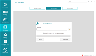

Have you tried to go through the Quick Start portion of the DLP3010EVM-LC EVM User's Guide?
Also, what was happening just before this image started to be displayed and nothing else was shown? Were you trying to reprogram the firmware?
What version of firmware is on the EVM now? Go to the EVM GUI 'Information' tab and press 'Get' while it is on and image is being displayed. The bottom left of the GUI should show "EVM Status: Connected ...", something like this:
Aaron

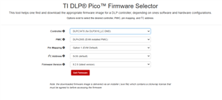

Thank you for including an image of the GUI and EVM Information! I can't see the EVM status at the bottom left, but does it seem like your EVM needs to be updated to the latest software.
Please select the DLP3010EVM-LC (DLPC3478 controller) within the Firmware Selector Tool - v9.2.0. Your version is very out of date or possibly someone programmed it incorrectly with a different controller firmware?? How long ago was this EVM purchased?

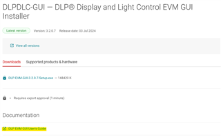

Please also update the EVM GUI (DLPDLC-GUI) to the latest 3.2.0.7 version from the DLP3010EVM-LC ti.com page here.
After all software and firmware has been gathered, please reflash the EVM using the Firmware / Flash Firmware page of the GUI to update to the latest.
Please use the DLPDLC-GUI User's Guide as a reference as well, this will enable you further.

Was the EVM ever working previously?
It looks like the wrong pinmapping is sent to the EVM. The firmware selection you should have selected would have been FWSel_DLPC3478_DLPA2005_pm1_i2c0x36_v9p2p0.img

Additionally, you can try programming with this backup image.
Aaron
https://e2e.ti.com/cfs-file/__key/communityserver-discussions-components-files/94/1072.7_5F00_DLP3010-_2800_.3-720p_29005F00_DLPC3478_5F00_Single_5F00_Backup.img
I included it in the last message, you'll need to put that in the folder and then load it in. This is the 'Flash Firmware' tab of the GUI.
