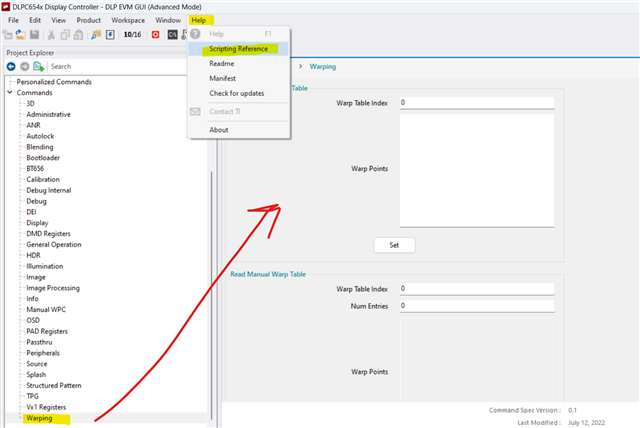

I don't understand how to control warping.
Is there an example script file or code for Warping control on DLP471TPEVM (DLPC6540 controller) ?
  • Hello User,
    Welcome to the E2E forums and we hope to assist you with your questions.
    You can download the GUI to control the EVM.
    https://www.ti.com/tool/DLPDLC-GUI
    If you go to advanced mode, you will find commands for warping.
    If you go to help and select scripting reference, you will find information on how to run these warping commands.
    Alex Chan
  • Hello User,
    Beside the information above, please also refer to the DLPC6540 Programmer's Guide Section 19.13 for more Warping information.

  • Thank you for your answer.
    I also know the GUI tool - advanced - Warping menu.
    But there are two types of distortion as below.
    There are "pincusion" and "barrel" types. How should I apply each of them?
    Can you give me an example of how to do this?

  • Hello Lori,
    I created a test script file as below and did a warping test.
    However, there is no change on screen.
    Please check the log message that ran the script file as below.
    1. script code
    Summary = WriteManualWarpTableUpdateMode (0)
    if Summary.Successful:
    print("[Warping] Write Manual WarpTable Update")
    else:
    print("[Warping] Failed to Write Manual WarpTable Update")
    ControlPointsDefinedByArray = 0
