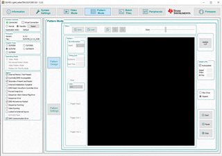

However, the board always stays in Standby mode, if I click the Normal radio-button, it will go back to standby mode after a few seconds. If I click the GUI's Reset button, it will go into Normal mode but the secondary controller will not startup and D9 is not flashing. When I tried to upload LUT, the GUI showed an error that Send command to Secondary failed, see the screenshot below. The secondary controller can startup again only if the PCB reset button is pressed but the board will always be in standby mode.

  • Hello Hongtao,
    Thank you for including the image! From the image we see that you are utilizing a v6.1.0  firmware with a v5.3.0 software GUI. You will need to utilize a v6.3.0 firmware.
    Please upgrade and reach back out if needed!
    Aaron

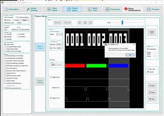

  • Hi Aaron
    Thank you for your reply. I have now upgraded the firmware, unfortunately, the issue still persists. Please see the screenshot below for your reference.
    The GUI shows a 'DMD communication error', this is because a DMD circuit is not enabled due to a circuit fault. I have done the same test with your DLPLCRC900DEVM board without connecting the two flexi cables (so GUI also shows the error), the secondary controller on your board can be reset via GUI. So there must be something wrong with my board.
    From the UART debug message of the first controller, I can see that it communicates with IT6535 after power on, however, my board doesn't have IT6535 as it is obsoleted, would this cause any problem please?

  • Hello Hongtao,
    Few comments:
    1. The system will not transition to Normal mode, because there is no DMD. DLPC900 controllers will remain in Standby and cannot accept any display/pattern commands. See Appendix A.2 of DLPC900 Programmer's Guide
    2. Currently, the DLPC900 interfaces with IT6535. You can disable the IT6535 configuration by changing the FW configuration. Select the FW images, disable HDMI/DP receiver in 'Firmware' page, update firmware.
    3. Regarding the reset of Secondary controller, please capture the UART logs from the Secondary controller as well. We will try to reproduce at our lab as well.
