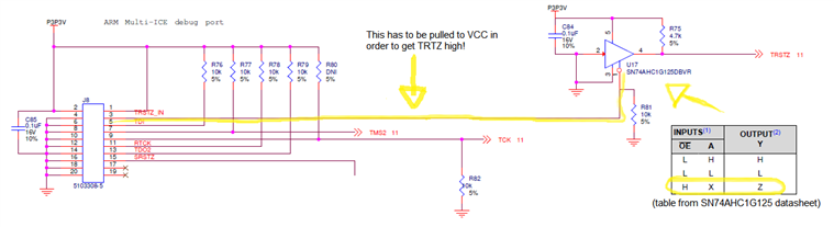

  • Hi!
    Edit: I just realised that the problem I'm describing in the following was fixed in a later board revision (starting from Rev G). I have an older board. So the following is only useful for revisions older than G!
    It took me a few days to get the JTAG firmware-upload working - and to figure out why it wasn’t working in the first place. Actually, I’m a bit skeptical that anybody ever got it to work for this EVM according to 6.11 in the user guide ... I thought it might be helpful for somebody who runs into the same problem as I did if I briefly describe what solved the issue for me.
    When the FlashProgrammer.exe couldn’t connect to the EVM I checked the JTAG lines. Everything looked normal, except the reset line (TRSTZ) constantly remained at low level (actually, it sat at a few hundred mV). Looking at the DLPC900 datasheet (Table 4-7), it was clear that this pin has to be pulled high for the JTAG to work. As it turned out, the TRSTZ pin on the UM232H module actually went high when not connected to the EVM. Thus, the circuitry of the EVM prevented TRSTZ from going high. The circuit diagram of the DLPLCR65EVM shows why imho TRSTZ can’t ever be pulled high through J10 (the JTAG header on the EVM). The TRSTZ is directly connected to the output of the buffer U17 (its pin 4). U17 will only output a high level when its /OE input (pin 1) is high, however it is pulled down by R81. Only when /OE is high the U17 output goes high-Z and R75 pulls TRSTZ high. Thus, when the UM232H is connected to EVM, both “fight” for the TRSTZ level – and obviously U17 wins by permanently pulling it down (at least almost, that also explains why I saw the positive offset when initially looking at the level of TRSTZ).
    However, it is luckily pretty easy to pull /OE of U17 high because it is present on J8 as TRSTZ_IN. Even better, right next to its pin on J8 is a VCC pin. Thus, connecting these two pins by a jumper sets TRSTZ_IN high, which sets TRSTZ high and finally enables the JTAG to work. By setting that jumper I was eventually able to flash the bootloader!
    Unfortunately, the new bootloader didn’t bring back my EVM to life. However, I will post about that problem in my next reply to keep the thread a bit more structured.

  • Malte,
    This is FANTASTIC!  As I mentioned the USB function is part of the bootloader and if it gets corrupted it often does not work.
    I am very glad you got this working.
