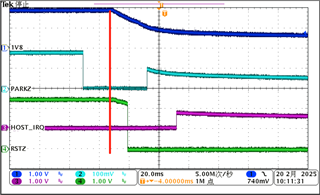

Dear TI engineer,
         I found that the DLPC3432 power off sequence was abnormal when i tested the waveform.The specifications require RESETZ to power off the controller first, and then power off the controller.
But I found out the power went down first.Does this timing cause any anomalies?
