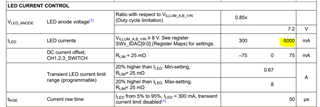

Is the DLPA3005DPFD a drop-in replacement for the DLPA3000DPFD? I have a circuit working with the DLPA3000DPFD device. Can the device be replaced with a DLPA3005DPFD? I want to use the DLPA3005 to get the increased forward voltage for LEDs. The DLPA3005 output can go to a higher LED voltage.
  • The circuit will be used for LED currents less than 6A. Is the DLPA3005 a drop in replacement when the LED current is 2A or less? The datasheet shows that the DLPA3005 needs external MOSFETS if a LED current as high as 16A is needed. What will happen if the DLPA3005 is used in the same circuit that works for a DLPA3000 when the LED current is 2A or less?
  • Comparing datasheets and circuits, it depends on whether the DLPA3005 has the same current drive on the signals CH1_SWITCH, CH2_SWITCH, and CH3_SWITCH. These signals are active low. Can these signals take 2A the same as the DLPA3000? Table 5-1 Pin Functions on the DLPA3005 datasheet has the same description as the DLPA3000.

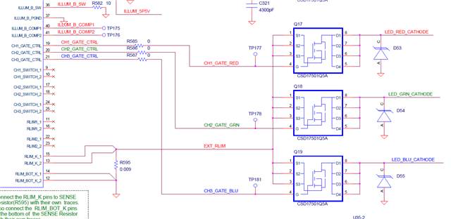

  • Hello David,
    The DLPA3005 has to use external power MOSFETs for illumination, please refer to the reference design on DLP4710EVM-LC. That means you need to change your current design.
    The max LED currents on DLPA3000 is 6A, if you use LED current less than 2A, why don't you just keep your design as DLPA3000?
    Lori

  • Hello David,
     I'm sorry for the confusion, Figure 8-3 in the DLPA3005 datasheet is not correct for these CHX_SWITCH and CHX_GATE_CTRL pins. We will need to fix this diagram.
    Please refer to the schematic, CHX_GATE_CTRL need to connect to MOSFETs which is different with DLPA3000 design.
    Lori

  • Hello David,
    The figure 8-3 in the DLPA3005 datasheet is not correct as I mentioned before. Please refer and compare the schematic for DLPA3000 and DLPA3005, then you will see the different. The internal design for the illumination block are different.
    Lori

  • Hi David,
    If you want to use DLPA3005 to replace with DLPA3000, then you have to use these five MOSFETs.
    Do you have your own custom design board or you are using TI EVM? What's he controller and DMD you are using?
