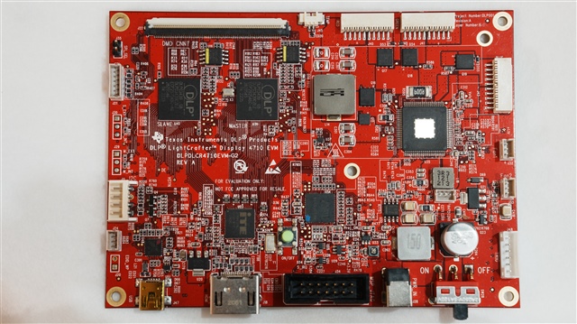

Ensure all LED cables are securely connected to the electronics board. See that the DMD flex PCB is firmly fitted to the electronics board as well.
Please try flashing the EVM again with a compatible FW build.

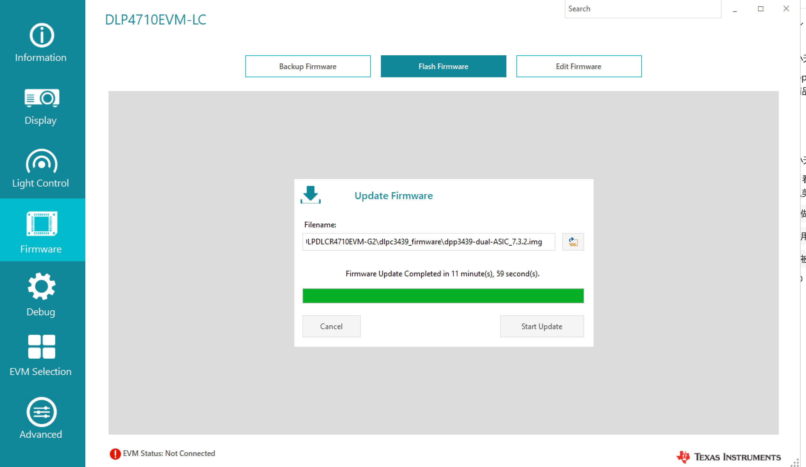

If the Light Crafter GUI is failing to connect, please try the GUI on this page: https://www.ti.com/tool/DLP4710EVM-LC.
Go to the FW tab, backup your current image if you haven't already, then attempt to program the EVM.
John
Hi, thanks, I've downloaded the software DLP-EVM-GUI-3.2.0.7-Setup.exe as your guide. After I installed the GUI and used the firmware
dpp3439-dual-ASIC_7.3.2.img
which I downloaded from DLPDLCR4710EVM-G2 page and updated the firmware. It showed completed.
After I powered off and then powered on and then pressed the SW21, the issue remained the same: the light system did not seem to work.

GPIO 1 and 2 should be pulled high, meaning the output will go to HOST IRQ output pin. You can all read this signal from U25 on PIN 2 of the IC. U25 is located to the right of the green push button. It is a 5 pin leaded IC. You would connect your RX cable to this pin to get output from the firmware.
