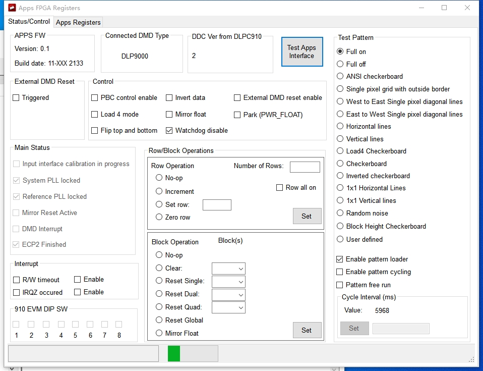

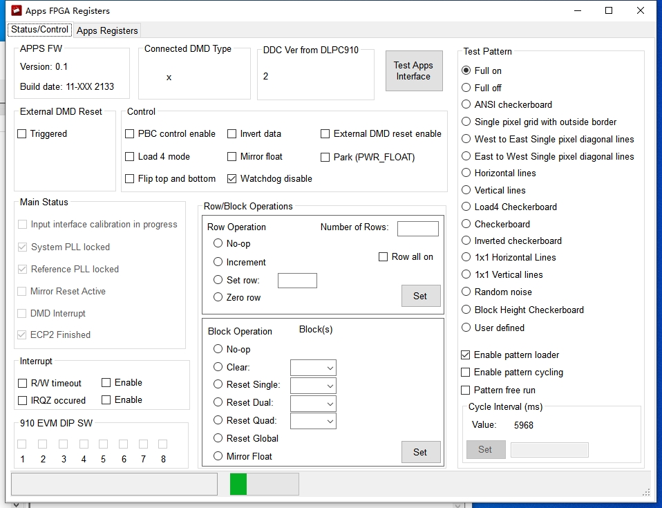

上图为实际测试时出现的现象,Apps FW的Version:0.1;Build Date:11-xxx-2133;Connected DMD Type:x与DLP9000之间变化。

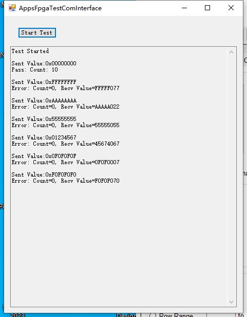

在点击界面中的Test Apps Interface后,出现报错,如下图所示

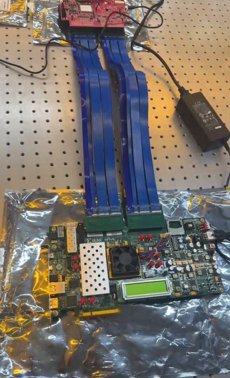

  • Hello HuiLong,
     Do you have this connected to a Xilinx VC707 board?
    Fizix
  •  Yes, the Xilinx VC707 development board is connected normally.

  • Hello Bing,
    I think a phone conference would be more productive.  Please let me know your time zone and availability.
    Fizix

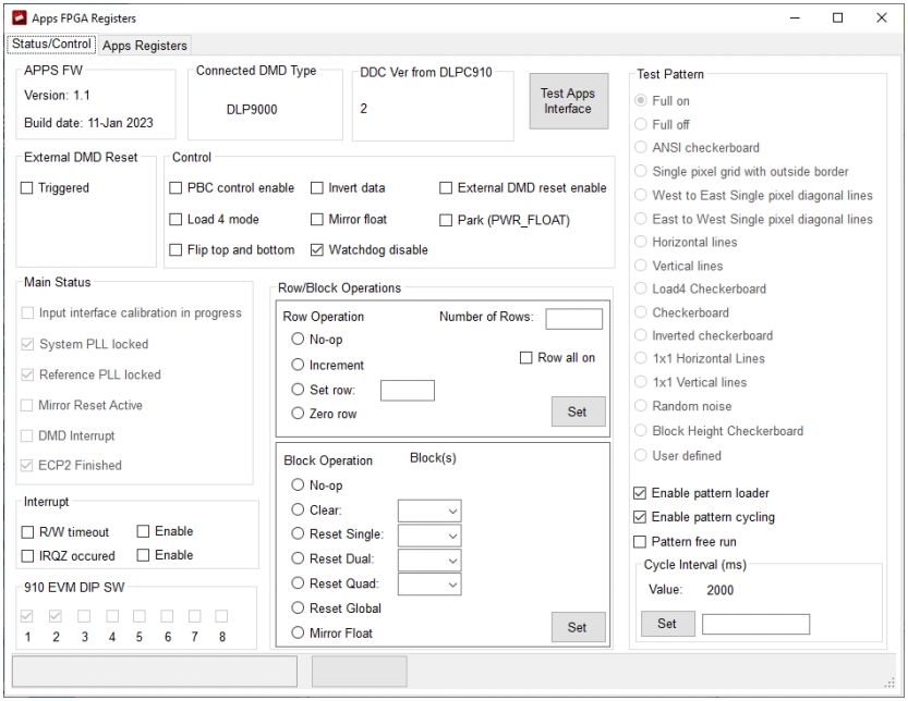

  • Bing,
    I am glad you determined that it was a problem with the cables.
