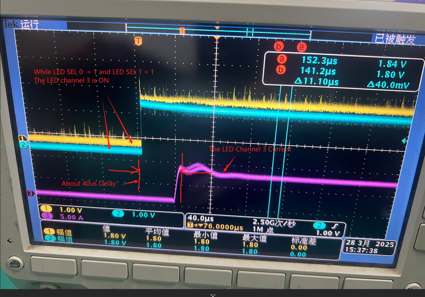

 :In the DLP4710 project, there is also a control delay of approximately 40μs, as shown in the figure. This issue has similarly caused a non-linearity problem during the 127-to-128 grayscale transition in the DLP4710 system. The phenomenon becomes even more pronounced when we switch to LEDs of different type. This thread is specific to the DLP4500. Therefore, do you means that no solution can be provided within this thread, and that I need to create a new post under the DLP4710 project for further assistance?
