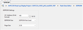

i just want to know what data i have to program in EEPROM in DMD board befor i start to display DMD, if i just make new dmd board from lg innotek.
EEPROM is M24512-DRMN8TP/K.

Hello Myungjin,
HUD dimming calibration data can be stored in either the SPI flash or the optional EEPROM.
To use EEPROM to store calibration data, enable this option in your composer project:
