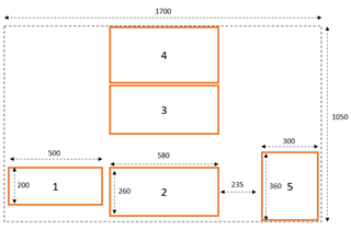

The mechanical holders are arranged in a 1700x1050 mm area, and the projector lens should be placed at a distance of about 550-650 mm. The throw ratio is about 0.337-0.34. We cannot increase the projector distance because of mechanical limits of the chamber (the projector should be placed inside the chamber). Note that only a small area of the entire projection area should be highlighted at a time (from 50x50 mm to 270x150 mm). Mechanical holders are grouped into zones inside the entire projection area, so we can also evaulate multiple projectors, one for each zone. The zones are arranged in this way (all measures are in mm and approximate) from the point of view of the projector:
This is a side view:
Zones 2, 3, and 4 have same dimensions. Please note that red lengths are the available space inside the chamber. If a single projector is not feasible, we can evaluate multiple projectors (I think one for zone 1, one for zone 5 and one for zones 2,3,4).
