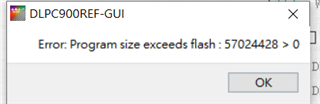

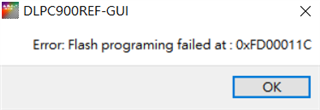

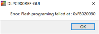

  • Hi Aishwarya
    I tested modifying the parameters in the FlashDeviceParameters.txt file, but it did not resolve the issue.
    Here is a summary of my test results:
    Mb parameter:
    8             Error:Program size exceeds flash : 57024428 > 33554432
    16           Error:Program size exceeds flash : 57024428 > 16777216
    32           Error:Flash programing failed at:                           occasionally stuck at Slave 99%
    64           Error:Flash programing failed at:                          occasionally stuck at Slave 99%
    128         Error:Flash programing failed at:                          occasionally stuck at Slave 99%
    256         Error:Flash programing failed at:0xFD00011C       stuck at master 88%
    512         Error:Flash programing failed at:0xFB020090       stuck at master 58%
    1024       Error:Flash programing failed at:0xFB020090       stuck at master 58%
    2048       Error:Program size exceeds flash:57024428 > 0
    Size parameter:None of them affect

    //Fail Error:Program size exceeds flash:57024428 > 0
    "Infineon",   0x0001, 0x0000000000000001, "S29GL01GS", 0x227E, 0x000000000000227E, 2048, 0, 0x10000000, 2048,  0, 0x10000, 0x20000, 0x30000, 0x40000, 0x80000, 0xC0000, 0x100000, 0x140000, 0x180000, 0x1C0000, 0x200000, 0x240000, 0x280000, 0x2C0000, 0x300000, 0x340000, 0x380000, 0x3C0000, 0x400000, 0x440000, 0x480000, 0x4C0000, 0x500000, 0x540000, 0x580000, 0x5C0000, 0x600000, 0x640000, 0x680000, 0x6C0000, 0x700000, 0x740000, 0x780000, 0x7C0000, 0x800000, 0x840000, 0x880000, 0x8C0000, 0x900000, 0x940000, 0x980000, 0x9C0000, 0xA00000, 0xA40000, 0xA80000, 0xAC0000, 0xB00000, 0xB40000, 0xB80000, 0xBC0000, 0xC00000, 0xC40000, 0xC80000, 0xCC0000, 0xD00000, 0xD40000, 0xD80000, 0xDC0000, 0xE00000, 0xE40000, 0xE80000, 0xEC0000, 0xF00000, 0xF40000, 0xF80000, 0xFC0000, 0xFD0000, 0xFE0000, 0xFF0000,

    //stuck at master 88%  0xFD00011C
    "Cypress",    0x0001, 0x0000001,"S70GL02GS",   0x227E, 0x000227E,       256,         0, 0x2000000,       256, 0x0000000, 0x0020000, 0x0040000, 0x0060000, 0x0080000, 0x00A0000, 0x00C0000, 0x00E0000, 0x0100000, 0x0120000, 0x0140000, 0x0160000, 0x0180000, 0x01A0000, 0x01C0000, 0x01E0000, 0x0200000, 0x0220000, 0x0240000, 0x0260000, 0x0280000, 0x02A0000, 0x02C0000, 0x02E0000, 0x0300000, 0x0320000, 0x0340000, 0x0360000, 0x0380000, 0x03A0000, 0x03C0000, 0x03E0000, 0x0400000, 0x0420000, 0x0440000, 0x0460000, 0x0480000, 0x04A0000, 0x04C0000, 0x04E0000, 0x0500000, 0x0520000, 0x0540000, 0x0560000, 0x0580000, 0x05A0000, 0x05C0000, 0x05E0000, 0x0600000, 0x0620000, 0x0640000, 0x0660000, 0x0680000, 0x06A0000, 0x06C0000, 0x06E0000, 0x0700000, 0x0720000, 0x0740000, 0x0760000, 0x0780000, 0x07A0000, 0x07C0000, 0x07E0000, 0x0800000, 0x0820000, 0x0840000, 0x0860000, 0x0880000, 0x08A0000, 0x08C0000, 0x08E0000, 0x0900000, 0x0920000, 0x0940000, 0x0960000, 0x0980000, 0x09A0000, 0x09C0000, 0x09E0000, 0x0A00000, 0x0A20000, 0x0A40000, 0x0A60000, 0x0A80000, 0x0AA0000, 0x0AC0000, 0x0AE0000, 0x0B00000, 0x0B20000, 0x0B40000, 0x0B60000, 0x0B80000, 0x0BA0000, 0x0BC0000, 0x0BE0000, 0x0C00000, 0x0C20000, 0x0C40000, 0x0C60000, 0x0C80000, 0x0CA0000, 0x0CC0000, 0x0CE0000, 0x0D00000, 0x0D20000, 0x0D40000, 0x0D60000, 0x0D80000, 0x0DA0000, 0x0DC0000, 0x0DE0000, 0x0E00000, 0x0E20000, 0x0E40000, 0x0E60000, 0x0E80000, 0x0EA0000, 0x0EC0000, 0x0EE0000, 0x0F00000, 0x0F20000, 0x0F40000, 0x0F60000, 0x0F80000, 0x0FA0000, 0x0FC0000, 0x0FE0000, 0x1000000, 0x1020000, 0x1040000, 0x1060000, 0x1080000, 0x10A0000, 0x10C0000, 0x10E0000, 0x1100000, 0x1120000, 0x1140000, 0x1160000, 0x1180000, 0x11A0000, 0x11C0000, 0x11E0000, 0x1200000, 0x1220000, 0x1240000, 0x1260000, 0x1280000, 0x12A0000, 0x12C0000, 0x12E0000, 0x1300000, 0x1320000, 0x1340000, 0x1360000, 0x1380000, 0x13A0000, 0x13C0000, 0x13E0000, 0x1400000, 0x1420000, 0x1440000, 0x1460000, 0x1480000, 0x14A0000, 0x14C0000, 0x14E0000, 0x1500000, 0x1520000, 0x1540000, 0x1560000, 0x1580000, 0x15A0000, 0x15C0000, 0x15E0000, 0x1600000, 0x1620000, 0x1640000, 0x1660000, 0x1680000, 0x16A0000, 0x16C0000, 0x16E0000, 0x1700000, 0x1720000, 0x1740000, 0x1760000, 0x1780000, 0x17A0000, 0x17C0000, 0x17E0000, 0x1800000, 0x1820000, 0x1840000, 0x1860000, 0x1880000, 0x18A0000, 0x18C0000, 0x18E0000, 0x1900000, 0x1920000, 0x1940000, 0x1960000, 0x1980000, 0x19A0000, 0x19C0000, 0x19E0000, 0x1A00000, 0x1A20000, 0x1A40000, 0x1A60000, 0x1A80000, 0x1AA0000, 0x1AC0000, 0x1AE0000, 0x1B00000, 0x1B20000, 0x1B40000, 0x1B60000, 0x1B80000, 0x1BA0000, 0x1BC0000, 0x1BE0000, 0x1C00000, 0x1C20000, 0x1C40000, 0x1C60000, 0x1C80000, 0x1CA0000, 0x1CC0000, 0x1CE0000, 0x1D00000, 0x1D20000, 0x1D40000, 0x1D60000, 0x1D80000, 0x1DA0000, 0x1DC0000, 0x1DE0000, 0x1E00000, 0x1E20000, 0x1E40000, 0x1E60000, 0x1E80000, 0x1EA0000, 0x1EC0000, 0x1EE0000, 0x1F00000, 0x1F20000, 0x1F40000, 0x1F60000, 0x1F80000, 0x1FA0000, 0x1FC0000, 0x1FE0000,
    //stuck at master 58%  0xFB020090
    "Cypress",    0x0001, 0x0000001,"S70GL02GS",   0x227E, 0x000227E,       512,         0, 0x4000000,       512, 0x0000000, 0x0020000, 0x0040000, 0x0060000, 0x0080000, 0x00A0000, 0x00C0000, 0x00E0000, 0x0100000, 0x0120000, 0x0140000, 0x0160000, 0x0180000, 0x01A0000, 0x01C0000, 0x01E0000, 0x0200000, 0x0220000, 0x0240000, 0x0260000, 0x0280000, 0x02A0000, 0x02C0000, 0x02E0000, 0x0300000, 0x0320000, 0x0340000, 0x0360000, 0x0380000, 0x03A0000, 0x03C0000, 0x03E0000, 0x0400000, 0x0420000, 0x0440000, 0x0460000, 0x0480000, 0x04A0000, 0x04C0000, 0x04E0000, 0x0500000, 0x0520000, 0x0540000, 0x0560000, 0x0580000, 0x05A0000, 0x05C0000, 0x05E0000, 0x0600000, 0x0620000, 0x0640000, 0x0660000, 0x0680000, 0x06A0000, 0x06C0000, 0x06E0000, 0x0700000, 0x0720000, 0x0740000, 0x0760000, 0x0780000, 0x07A0000, 0x07C0000, 0x07E0000, 0x0800000, 0x0820000, 0x0840000, 0x0860000, 0x0880000, 0x08A0000, 0x08C0000, 0x08E0000, 0x0900000, 0x0920000, 0x0940000, 0x0960000, 0x0980000, 0x09A0000, 0x09C0000, 0x09E0000, 0x0A00000, 0x0A20000, 0x0A40000, 0x0A60000, 0x0A80000, 0x0AA0000, 0x0AC0000, 0x0AE0000, 0x0B00000, 0x0B20000, 0x0B40000, 0x0B60000, 0x0B80000, 0x0BA0000, 0x0BC0000, 0x0BE0000, 0x0C00000, 0x0C20000, 0x0C40000, 0x0C60000, 0x0C80000, 0x0CA0000, 0x0CC0000, 0x0CE0000, 0x0D00000, 0x0D20000, 0x0D40000, 0x0D60000, 0x0D80000, 0x0DA0000, 0x0DC0000, 0x0DE0000, 0x0E00000, 0x0E20000, 0x0E40000, 0x0E60000, 0x0E80000, 0x0EA0000, 0x0EC0000, 0x0EE0000, 0x0F00000, 0x0F20000, 0x0F40000, 0x0F60000, 0x0F80000, 0x0FA0000, 0x0FC0000, 0x0FE0000, 0x1000000, 0x1020000, 0x1040000, 0x1060000, 0x1080000, 0x10A0000, 0x10C0000, 0x10E0000, 0x1100000, 0x1120000, 0x1140000, 0x1160000, 0x1180000, 0x11A0000, 0x11C0000, 0x11E0000, 0x1200000, 0x1220000, 0x1240000, 0x1260000, 0x1280000, 0x12A0000, 0x12C0000, 0x12E0000, 0x1300000, 0x1320000, 0x1340000, 0x1360000, 0x1380000, 0x13A0000, 0x13C0000, 0x13E0000, 0x1400000, 0x1420000, 0x1440000, 0x1460000, 0x1480000, 0x14A0000, 0x14C0000, 0x14E0000, 0x1500000, 0x1520000, 0x1540000, 0x1560000, 0x1580000, 0x15A0000, 0x15C0000, 0x15E0000, 0x1600000, 0x1620000, 0x1640000, 0x1660000, 0x1680000, 0x16A0000, 0x16C0000, 0x16E0000, 0x1700000, 0x1720000, 0x1740000, 0x1760000, 0x1780000, 0x17A0000, 0x17C0000, 0x17E0000, 0x1800000, 0x1820000, 0x1840000, 0x1860000, 0x1880000, 0x18A0000, 0x18C0000, 0x18E0000, 0x1900000, 0x1920000, 0x1940000, 0x1960000, 0x1980000, 0x19A0000, 0x19C0000, 0x19E0000, 0x1A00000, 0x1A20000, 0x1A40000, 0x1A60000, 0x1A80000, 0x1AA0000, 0x1AC0000, 0x1AE0000, 0x1B00000, 0x1B20000, 0x1B40000, 0x1B60000, 0x1B80000, 0x1BA0000, 0x1BC0000, 0x1BE0000, 0x1C00000, 0x1C20000, 0x1C40000, 0x1C60000, 0x1C80000, 0x1CA0000, 0x1CC0000, 0x1CE0000, 0x1D00000, 0x1D20000, 0x1D40000, 0x1D60000, 0x1D80000, 0x1DA0000, 0x1DC0000, 0x1DE0000, 0x1E00000, 0x1E20000, 0x1E40000, 0x1E60000, 0x1E80000, 0x1EA0000, 0x1EC0000, 0x1EE0000, 0x1F00000, 0x1F20000, 0x1F40000, 0x1F60000, 0x1F80000, 0x1FA0000, 0x1FC0000, 0x1FE0000, 0x2000000, 0x2020000, 0x2040000, 0x2060000, 0x2080000, 0x20A0000, 0x20C0000, 0x20E0000, 0x2100000, 0x2120000, 0x2140000, 0x2160000, 0x2180000, 0x21A0000, 0x21C0000, 0x21E0000, 0x2200000, 0x2220000, 0x2240000, 0x2260000, 0x2280000, 0x22A0000, 0x22C0000, 0x22E0000, 0x2300000, 0x2320000, 0x2340000, 0x2360000, 0x2380000, 0x23A0000, 0x23C0000, 0x23E0000, 0x2400000, 0x2420000, 0x2440000, 0x2460000, 0x2480000, 0x24A0000, 0x24C0000, 0x24E0000, 0x2500000, 0x2520000, 0x2540000, 0x2560000, 0x2580000, 0x25A0000, 0x25C0000, 0x25E0000, 0x2600000, 0x2620000, 0x2640000, 0x2660000, 0x2680000, 0x26A0000, 0x26C0000, 0x26E0000, 0x2700000, 0x2720000, 0x2740000, 0x2760000, 0x2780000, 0x27A0000, 0x27C0000, 0x27E0000, 0x2800000, 0x2820000, 0x2840000, 0x2860000, 0x2880000, 0x28A0000, 0x28C0000, 0x28E0000, 0x2900000, 0x2920000, 0x2940000, 0x2960000, 0x2980000, 0x29A0000, 0x29C0000, 0x29E0000, 0x2A00000, 0x2A20000, 0x2A40000, 0x2A60000, 0x2A80000, 0x2AA0000, 0x2AC0000, 0x2AE0000, 0x2B00000, 0x2B20000, 0x2B40000, 0x2B60000, 0x2B80000, 0x2BA0000, 0x2BC0000, 0x2BE0000, 0x2C00000, 0x2C20000, 0x2C40000, 0x2C60000, 0x2C80000, 0x2CA0000, 0x2CC0000, 0x2CE0000, 0x2D00000, 0x2D20000, 0x2D40000, 0x2D60000, 0x2D80000, 0x2DA0000, 0x2DC0000, 0x2DE0000, 0x2E00000, 0x2E20000, 0x2E40000, 0x2E60000, 0x2E80000, 0x2EA0000, 0x2EC0000, 0x2EE0000, 0x2F00000, 0x2F20000, 0x2F40000, 0x2F60000, 0x2F80000, 0x2FA0000, 0x2FC0000, 0x2FE0000, 0x3000000, 0x3020000, 0x3040000, 0x3060000, 0x3080000, 0x30A0000, 0x30C0000, 0x30E0000, 0x3100000, 0x3120000, 0x3140000, 0x3160000, 0x3180000, 0x31A0000, 0x31C0000, 0x31E0000, 0x3200000, 0x3220000, 0x3240000, 0x3260000, 0x3280000, 0x32A0000, 0x32C0000, 0x32E0000, 0x3300000, 0x3320000, 0x3340000, 0x3360000, 0x3380000, 0x33A0000, 0x33C0000, 0x33E0000, 0x3400000, 0x3420000, 0x3440000, 0x3460000, 0x3480000, 0x34A0000, 0x34C0000, 0x34E0000, 0x3500000, 0x3520000, 0x3540000, 0x3560000, 0x3580000, 0x35A0000, 0x35C0000, 0x35E0000, 0x3600000, 0x3620000, 0x3640000, 0x3660000, 0x3680000, 0x36A0000, 0x36C0000, 0x36E0000, 0x3700000, 0x3720000, 0x3740000, 0x3760000, 0x3780000, 0x37A0000, 0x37C0000, 0x37E0000, 0x3800000, 0x3820000, 0x3840000, 0x3860000, 0x3880000, 0x38A0000, 0x38C0000, 0x38E0000, 0x3900000, 0x3920000, 0x3940000, 0x3960000, 0x3980000, 0x39A0000, 0x39C0000, 0x39E0000, 0x3A00000, 0x3A20000, 0x3A40000, 0x3A60000, 0x3A80000, 0x3AA0000, 0x3AC0000, 0x3AE0000, 0x3B00000, 0x3B20000, 0x3B40000, 0x3B60000, 0x3B80000, 0x3BA0000, 0x3BC0000, 0x3BE0000, 0x3C00000, 0x3C20000, 0x3C40000, 0x3C60000, 0x3C80000, 0x3CA0000, 0x3CC0000, 0x3CE0000, 0x3D00000, 0x3D20000, 0x3D40000, 0x3D60000, 0x3D80000, 0x3DA0000, 0x3DC0000, 0x3DE0000, 0x3E00000, 0x3E20000, 0x3E40000, 0x3E60000, 0x3E80000, 0x3EA0000, 0x3EC0000, 0x3EE0000, 0x3F00000, 0x3F20000, 0x3F40000, 0x3F60000, 0x3F80000, 0x3FA0000, 0x3FC0000, 0x3FE0000,
