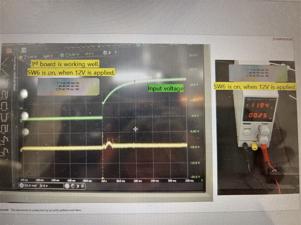

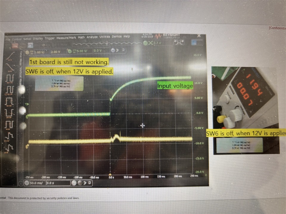

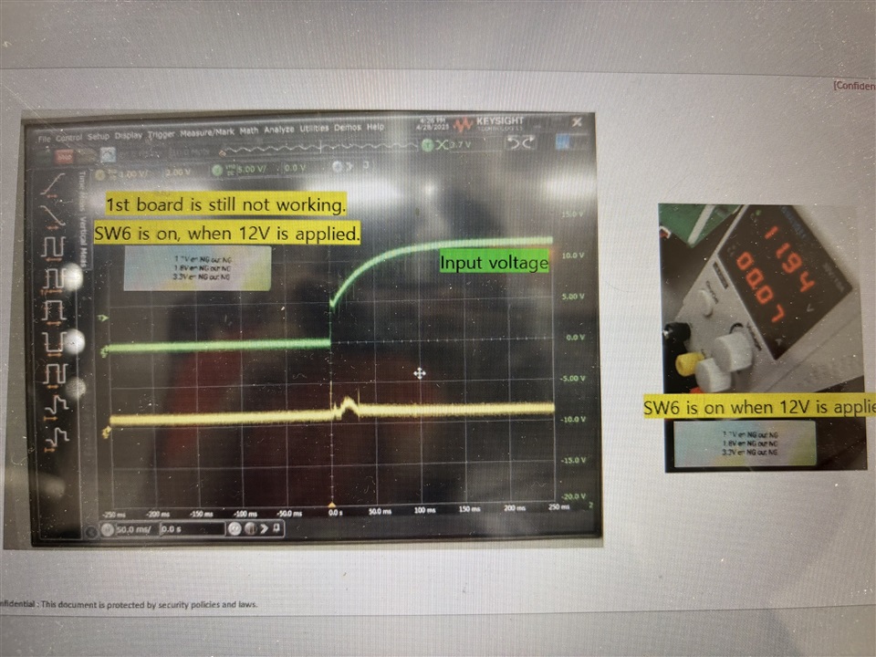

  • Hello
    I attached proj_on and en 1v1 about first board.
    I think proj_on is good, but en 1v1 is not output.
    Yellow is proj_on.
    Pink is en 1v1.
    Oddly enough, the second and third boards work fine again.

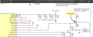

    Have you checked to see if your TPS99000 is receiving power adequate power? I would also probe the V_MAIN resistive divider node that the TPS99000S-Q1 uses.
    I would suggest you only use up to 18V for your input voltage, as the user's manual clearly states an input voltage max of 18V.

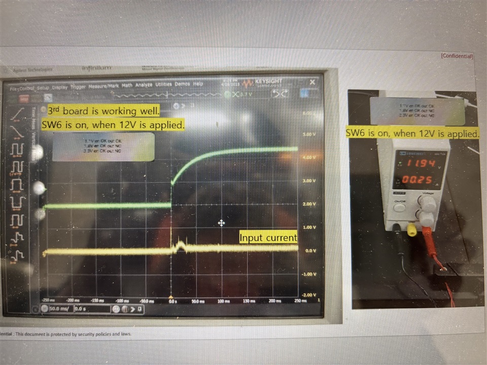

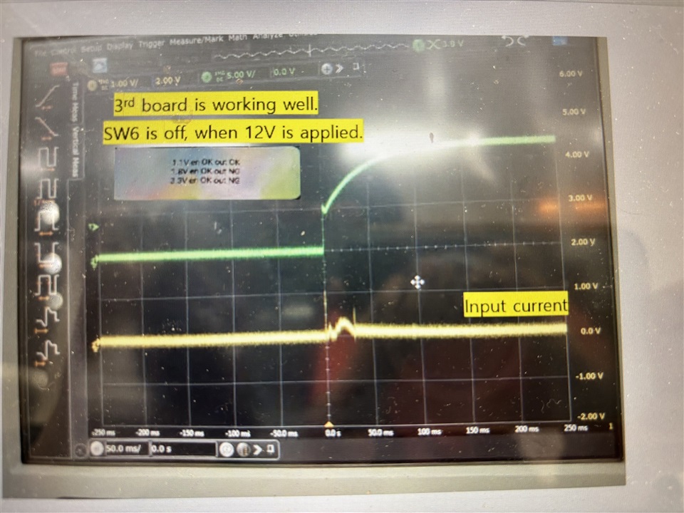

  • I missed inrush current results.
    3rd board

  • hello
    I have changed from TPS99001 to new one in fomatter board. All non working formatter is working well.
  • Hi Myungjin,
    Thanks for the update. I'll mark your answer as resolved. It appears swapping the TPS990001 solved the issue from a previously malfunctioning or damaged IC.
    Michael Ly
