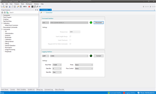

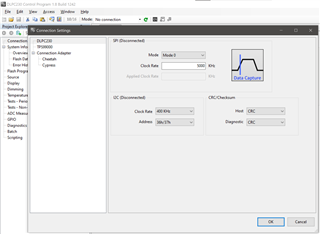

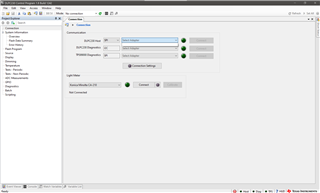

Despite the discrepancy, we have tried to connect to the EVM with the FTDI Adapter, following the user guide instructions, but nothing shows up in any of the Communication drop-down menus of the Control Program. We have tried with FTDI driver installed, as well as with Cheetah driver, but still nothing shows up in the drop-down. See Figures 1 and 2 below.
As a last resort check, we downloaded an alternative Control Program called DLPC136 DLP Control Program, which is intended for a different EVM, that also uses an FTDI adapter. With this Control Program, we are able to see the FTDI adapter in the drop-down, and connect (green light turns on). See Figure 3 below. However, we did not power up the EVM, as we did not know if this Control Program is compatible with the EVM. We simply wanted to test if our adapter is broken, but according to this test it does not appear so.

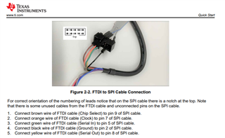

    Thanks for catching this. The FTDI cable is in fact intended to use the FTDI cable that we have provided. This is also shown inside the EVM User's Guide on the product page of this EVM. Please take a look at Figure 2-2 for the wiring.

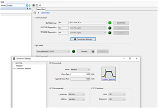

    Figure 2-7 then shows the SPI communication settings. You may use SPI mode 0 or 3. Please note the speed.. By default, DLPC23x Automotive Control Program uses 10,000 kHz as its clock speed. This is not correct. You must use 5000 kHz clock speed, as shown in the User's Guide.
    I have confirmed communication and confirmed a change in source image from checkerboard to horizontal ramp, for example.

    See picture below for FTDI cable connections, they are connected like shown on the user guide:

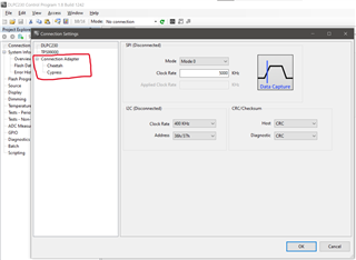

    On connection settings, I have the correct clock rate. Please note that on the side panel, under Connection Adapters, there is only Cheetah and Cypress listed:
    Further, in the program files accessed through file explorer, there is only connection adapter DLLs for Cheetah and Cypress. When re-installing the Control Program (from this link: DLPC110 Support software | TI.com), I also checked that indeed, only these two connection adapter DLLs are installed, there is nothing related to FTDI being installed as far as I see. Also the Readme.txt file lists only Cheetah and Cypress as host connection options.
