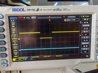

    Now we download the firmware to the spi chip xcf16pfsg48c, then the dlpc910 chip can load the configuration and run(can see this breathing LED working). But we monitor the signal SCPENZ, we have a pulse with only 15ns pulse width, and 6.25k freq. The dlp9000x book says it needs at least 1us pulse width to enable the chip. My question is, to have a good SCPENZ signal, is there another version of this firmware can be tried, or we should focus on the hardware trouble shooting?  BTW, we build the board with DLP9000X+DLPC910+XCF16PFSG48C+app FPGA. Thanks!
    Finlay
  • Finlay,
    If you have a heartbeat, that means that the controller code is configured and running.  Indeed at this point you should start looking to hardware.  Check the SCP bus for signals.  It should be attempting to read the DMD ID to determine which DMD is attached.
    Fizix
  • Fizix

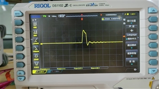

    We are trying to verify the SCPENZ signal again, we download the DLPC910A.mcs firmware to the prom chip XCF16PFSG48C and watch the SCPENZ signal, or we download the DLPC910A.bit to DLPC910 chip directly, in both way we couldn’t have a good SCPENZ signal, this is what we have on the scope:
    But if we watch a SCPENZ from a working DLPC910 control board, this is what we have:
    This two was totally different.
    So we doubt it could be a PCB failure or something with the DLPC910 chip, but looks like it’s not. This is what we have if we write a test program to the DLPC910 chip to make it output a pulse to the same pin SCPENZ:
    The yellow channel is the test signal on pin SCPENZ, pulse shapes are well formed, so the reason we don’t have a good SCPENZ signal doesn’t look like a pcb failure, but a firmware failure.

  • Hello Finlay,
    TI does not make the older FW available as a file.  It was available only in preprogrammed XCF16 DLPR910 chips.
    Please try downloading via JTAG the bit file to the DLPC910 directly on the working board and see if it fails SCPENZ or if it works as expected.  Downloading the bit file via JTAG will not cause an issue with what is programmed into the DLPR910 on the board.
