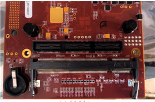

Could you please take a look at the impact of damage to this product on its use? Thank you
Hello Jack,
The damage looks isolated to the ability to hold DDR2 memory within J15.
I'm not sure if you're planning to utilize this connection or not, but it seems entirely mechanical.
If you have specific questions about the part, this is the 10033853-052FSLF produced by Amphenol - I would reach out to them for a replacement or try and patch it yourself - at your own risk.
This doesn't look like an issue to the DLPC410 EVM function but to be sure I've included an expert to respond to this.
