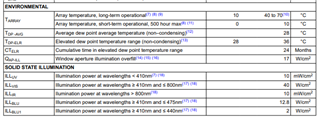

Also Is there any way we can use more powerful LEDs in existing DLP5530 and DLP4710EVM?

  • Hello Abhishek,
    The DLP781TE DMD does NOT have it's own EVM, this is correct. The offered DLP780TEEVM is a drop-in compatible solution as an EVM.
    Additionally, note that the DLP4710EVM-LC system is an all-in-one solution and TI does not own the optical engine design. I would recommend working with one of our optics development companies through our OMM-Search tool.

    Again, the DLP781TE DMD does not have its own EVM.
    To use more powerful LEDs, you would have to check the DMD's power density over different light spectra. Someone in our optical team or our list of OMMs could help design a system around that spec.
