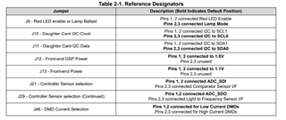

    1. Please check the jumpers are in the correct positions on the DLPC4430EVM. It also mentioned in section 2.2.2 of the EVM user's guide. J8 is the HOLD BL jumper, place this jumper when you programming the proper .img file. After programming successful, remove the jumper on J8.
    2. Figure 2-2. ON/OFF Switch is not correct. In the image, switch up should be ON, switch down should be OFF. Please make sure the switch is ON when programming.
    2. Do you use "Flash_DLPC4430_DLP650LE_p65_WXGA800_S450_LED.img" file? I cannot see in your screenshot. This is the correct image file for DLP650LEEVM.

  • Hello Yuji,
    Please try to remove J8 jumper; change J9, J10, J11 jumpers to Pin 2 and 3;remove J40 and J41; make sure UM232H is not connected as you mentioned.
    When you connect the 12V power supply, D9 and D10 Green LEDs should be ON; Then, switch SW1 to ON position, D15 Red LED should be ON for a second and OFF, D14 staring flashing.
    Please also double check the LED status even you mentioned they are fine.
    Lori
