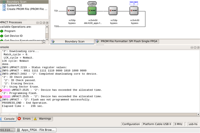

  • Yes, I tried turning off the ID check for the PROM by changing the environment variables. The programming of the FPGA does initialize, but it eventually errors out with a "Device has exceeded the allocated time" message. The D2 LED indicator is now red, which I believe indicates that the PROM has been corrupted. Furthermore, when I try connecting the DLPLCR70EVM to the DLPLCRC410EVM, the DMD is no longer detected (previously this was working fine). What should my next step be?
    Also, I have a question as to why I see two xcf16p devices appearing in the TDI chain after running the boundary scan? In the manual, it seems that only the xc5vlx50/xc5vlx30 are shown in the TDI chain?
  • Hello Pete,
    By default only the LX50 and it's PROM is in the chain.  If you add the LX30 (DLPC410) to the chain it shows up with it's PROM also.
    It sounds like the LX50 PROM did not program correctly.  Try connecting with JTAG again and use the file for the APPS_FPGA in the MySecure site.
    Fizix
    I've reconnected the JTAG and tried reprogramming the LX50 with the ddc4100_Apps-FPGA.bit file, following the instructions in the manual. Programming the flash terminates at around 9% with the error message "ERROR:iMPACT:2525 - '2': Device has exceeded the allocated time." I've also tried generating my own .mcs file using the .bit file, but get the same error. I've attached a screenshot of the console below.
    I also get an "exceeded the allocated time" error message during the step when it was erasing the device.
  • Pete,
    Which version of the Impact tool are you using and what platform cable are you using?  This sounds like an issue with a driver or software version.
    I also notice there is an item labeled "FLASH" attached to the LX50.  This is not the usual configuration of a DLPLCRC410EVM board.  I have never seen that before.
    Fizix
  • The Impact version I'm using is part of ISE 14.7, which I'm running on a virtual machine. For the platform cable, I'm using a Xilinx Platform Cable USB II (manufacturer #HW-USB-II-G). I'm surprised to hear that the box label "FLASH" attached to the LX50 is unexpected behavior. On page 13 of the "Programming Instructions DLPC410 EVM SPI PROM" manual, it instructs right clicking on the item labeled "FLASH" and then selecting Program. Is this the wrong procedure for the DLPLCRC410EVM board?
  • Pete,
    If your picture is correct, you do not have SPI PROMs but two XCF15 secure PROMs.  Do not use that box.  It is only if you have SPI PROMs on the board.
    I also suggest 14.1 if you get no joy with 14.7.  We have had mixed results with 14.7.
