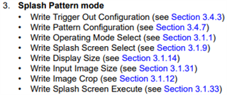

  • Hello Travis,
    If you have a video and know where it is you should be able to just drag-and-drop the video in.
    To answer your question, the Light Control version of splash won't be working by default. It defaults to the display application.
    You will need to perform the below writes:
    I would read through the DLPC3478 Software Programmer's Guide section 3.1.9 in depth as this describes how splash screens are working.
