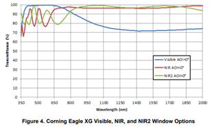

    Regarding the window transmittance of the DLP4500NIR, I referred to the application note you shared and extracted the following image from it (attached below).
    However, I am a bit confused — in the plot, which curve corresponds to the DLP4500NIR? Is it the red or the green one?

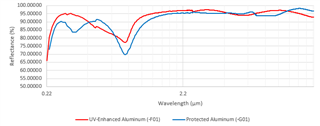

    In addition, concerning the micromirror reflectance, you mentioned that the DMD mirrors are aluminum-coated and should have relatively high reflectance over a broad spectral range.
    To estimate the reflectance, I looked up typical aluminum coatings on Thorlabs and found the attached plot. In this graph, the red curve shows UV-enhanced aluminum, and the blue curve represents protected aluminum.
    Would it be reasonable to use the blue curve (protected aluminum) as an approximation for the DLP4500NIR micromirror reflectance?

    The first graph applies to the window, which is common to most of our DMDs.  The newer DLP4500NIR DMDs will come with the NIR2 AR coating.
    For the second chart, the blue trace would be a good approximation.
