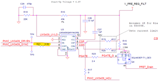

Hello
I have a question about LM3409.
1. In the DLP4620SQ1EVM circuit diagram, Roff and Coff are not connected separately, and the Sync period seems to be set in TPS99001. And 6.8k ohm is connected in series. Is that right?
2. In the LM3409 data sheet, there is an equation for the switching frequency. In order to know Toff, I need to know Coff and Roff, so how do you calculate switching frequency? And what is η? about 0.95?
3. I want to reduce ΔiL-PP as much as possible. How can I do that? I don't know how to calculate Roff and Coff since they are not connected.
4. To design ΔiL-PP close to '0', should I change LM3409 to another part?

    1. Yes, R_OFF appears to be in series, similar to the datasheet reference.
    2. Eta (η), the efficiency, is assumed to be 85% to 100%
      This is defined below in the datasheet:
    3. Section 9.2 shows an example for an arbitrary subsystem on how one would calculate values. The design process involves selecting your own COFF or ROFF value to calculate the other, and thus TOFF.

    The way that we use the LM3409 for our DLP application is a little different from the way the datasheet describes it.
    We have a sync signal that "hijacks" the COFF pin.
    T_OFF and T_ON vary from moment to moment, F_sw is not a constant value--it is ever-changing and non-periodic.
    The team for LM3409 can answer questions regarding this IC, as I specialize in DLP parts.
    TI is also still working on our own laser illumination design, but I suggest you reach back out to our TI engineer who previously messaged your team through email. Those emails already recommended not using the LM3409 and instead gave a concept for a different buck converter design. Please reach back out to that engineer for additional help with the hardware design.
    I will close this thread now because the general answer is the LM3409 will not work for laser illumination.
    The way TI uses this part uses a sync pulse to override the RC timer present in the typical design that pulls the COFF pin to GND via a capacitor. If this sync pulse, which we have little control over, pulses before minimum T_ON time is reached, the device might not properly turn off and continue to ramp up current. This can cause issues such as higher current than expected, and cause potential damage to the laser package. The LM3409 simply does not have a fast enough switching speed, nor does it have the proper fine-current-control capability.
