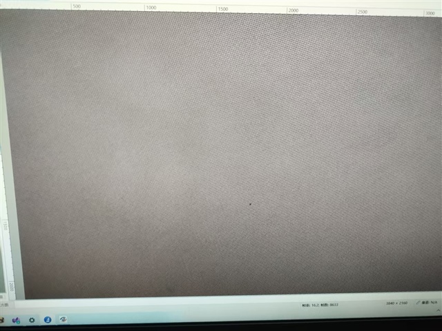

在正常的实验室环境中,使用程序输出图片,分别为 1920x1080 全黑图片和全白图片,每 1 秒更换一次图片。使用三目显微镜观察每个像素点,发现一个坏点。

Hi , What is your end application here?
Good afternoon LinYing Guo,

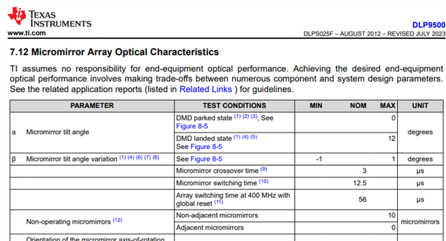

I see that you made another E2E post (https://e2e.ti.com/support/dlp-products-group/dlp/f/dlp-products-forum/1532643/dlp9500-dlp-products-forum) regarding the DLP9500 and seeing abnormal horizontal strips (bands) on the DMD. I do not know if there is a correlation between this bad pixel and the horizontal bands you are seeing on the DLP9500, but I would recommend following the recommended steps from that other E2E inquiry you have posted to see if those steps resolves this issue.
