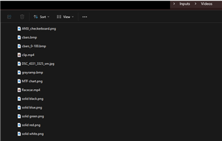

    Yes the composer tool does not allow making a New Project,
    For you to make a new one, you can simply import the  *.dlpxproj  again under a new  project name (which you downloaded from TI.com).
    Or you can also make a copy of the existing project that you are using, and do changes in it.
    If you are trying to add a custom image file, ensure that the file is also present in the Videos folder  (under the Inputs folder) of the composer project.(refer image below)
    The Composer tool available on https://www.ti.com/tool/DLP2021LEQ1EVM  is indeed a full featured version(not a demo) and should suffice for building a flash image with custom video/images.

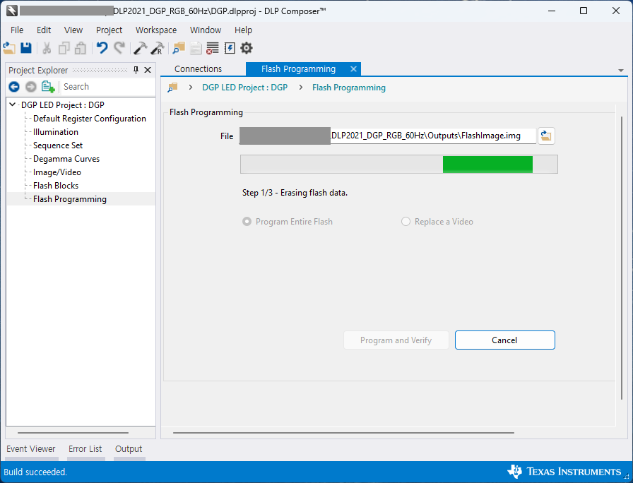

    I am reaching out to report an issue encountered while working with the DLP Composer tool. After successfully adding the intended image and proceeding with the flash programming process (as shown in the attached screenshot), I noticed that the system halts at Step 1/3 – Erasing flash data, without progressing further.
    The .img file (located at ...\Outputs\FlashImage.img) appears to be recognized correctly, and the project build completes without error. However, the flash operation does not proceed beyond the erase stage, and the "Program and Verify" button remains disabled.
    I would appreciate your guidance on the possible causes of this issue, and any recommended steps for resolution. Please let me know if additional logs or project files would be helpful for troubleshooting.

  • Dear [MYEONGJAE NOH],
    Could you please share me Error logs if any to help me narrow down the issue.
    Additionally could you please go to the connections page and share me the Screen capture of it.
    I suspect there could be problem with the Connections / some configuration on the connections page itself.
    Also have you tried the following workarounds:
    1) Restarting the Composer tool and trying again.
    2) Restarting the Hardware and trying again.
    Do let me know if this help you out.
