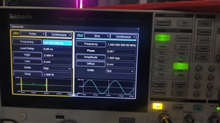

I am trying to project internal patterns stored in flash memory. The free running mode works fine and all patterns are being projected. But when I enable Trigger In mode and apply a trigger pulse generated from a function generator on the J4 connector's pin-5 3DR input, the patterns are not getting projected.
I have tried a combination of frequency, amplitude (3.3V and 5V), square wave, pulse wave with varied duty cycle, still no patterns are getting projected. Please help to resolve this issue.

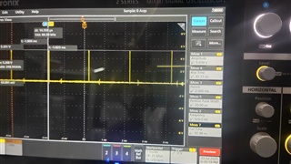

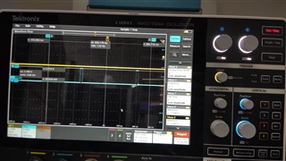

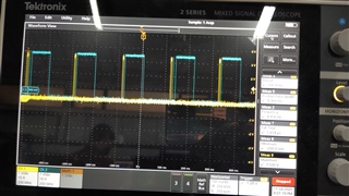

    I have enabled 'Pattern Ready' and set it to 'Active High' and monitored it in oscilloscope in Free Running Mode (Trigger-IN disabled) and Trigger In Mode (Trigger-IN enabled and set to Active High). The output images are attached below.
    1. Free Running Mode: Yellow line represent Pattern Ready signal (Pin-3) and Blue line represent Trigger OUT 2 signal (Pin-4) from projector
    From the first image, Is there any issue with the Trigger Out pulse because the Pattern Ready signal goes low before the last patterns trigger out signal

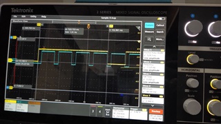

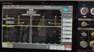

    2. Trigger In Mode: Yellow line represent Pattern Ready signal (Pin-3) and Blue line represent Trigger In signal supplied to (Pin-5) of the projector
    As from the second image, the projector is ready to receive trigger pulses, as the Pattern Ready signal is High. Even after supplying Trigger pulses of voltage 3.3V the projector does not project patterns. I generated the trigger pulses manually on a button click and also using function generator.
    What changes should I have to make in the pattern timing?

  • Hello Basith,

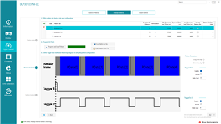

    #1 Free-running mode: Firstly, when in free-running mode there is no 'Pattern Ready.' The function of Internal Pattern is not utilized. Secondly, Pattern Ready and Trigger Out 2 are mutually exclusive outputs. What I mean is, Pattern Ready simply indicates that the controller is ready to accept an external trigger signal while Trigger Out 2 indicates the individual pattern trigger and is configured active (high/low) during the pattern exposure.
    #2 Trigger-In mode: From your second initial image, when you had pattern ready still disabled, the selection is 'Active Low' and if the Pattern Ready is 'High' this would indicate it is not ready to accept a trigger in signal. According to your photo, you have at least 3 pattern sets defined as 25ms (Pre-Exposure), 100ms (Exposure) and 6ms (Post-Exposure) + 3ms (Load time), this would total to 134ms or ~7.5Hz.
    I cannot be sure of what kind of patterns you are loading in but you should reference the latest release notes of the DLPC3478 software you are running (should be v9.2) through the Firmware Selector Tool. You should make sure you are within a defined exposure timing type/Exposure Time Range combination.
    You will also see at the bottom of the table that "Longer exposure times will operate with decreased timing accuracy and behavior is not guaranteed." Additionally, it is noted that "an additional variable delay of ~3000 us at the beginning of every pattern set" as I've mentioned before the 3ms buffer for 'Load Time.'
    Aaron

  • Hey Basith,
    Your questions:

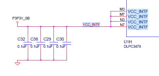

    1. Expected voltage range for trigger input pulse - DLPC3478 pin N6 (3DR) is any voltage of 1.8V, 2.5V, or 3.3V. Within the DLPC3478 DatasheetTable 5-10: I/O Type Subscript Definition shows that the supply reference is Vcc_INTF for this selected pins' I/O subscript (11). If you are following our EVM this is set to 3.3V.
    2. You should utilize a time that is within the same Exposure time sequence range.
    3. I've checked on my EVM and the timings that you have are good timings. I just didn't utilize the Trigger In function.
    Aaron
