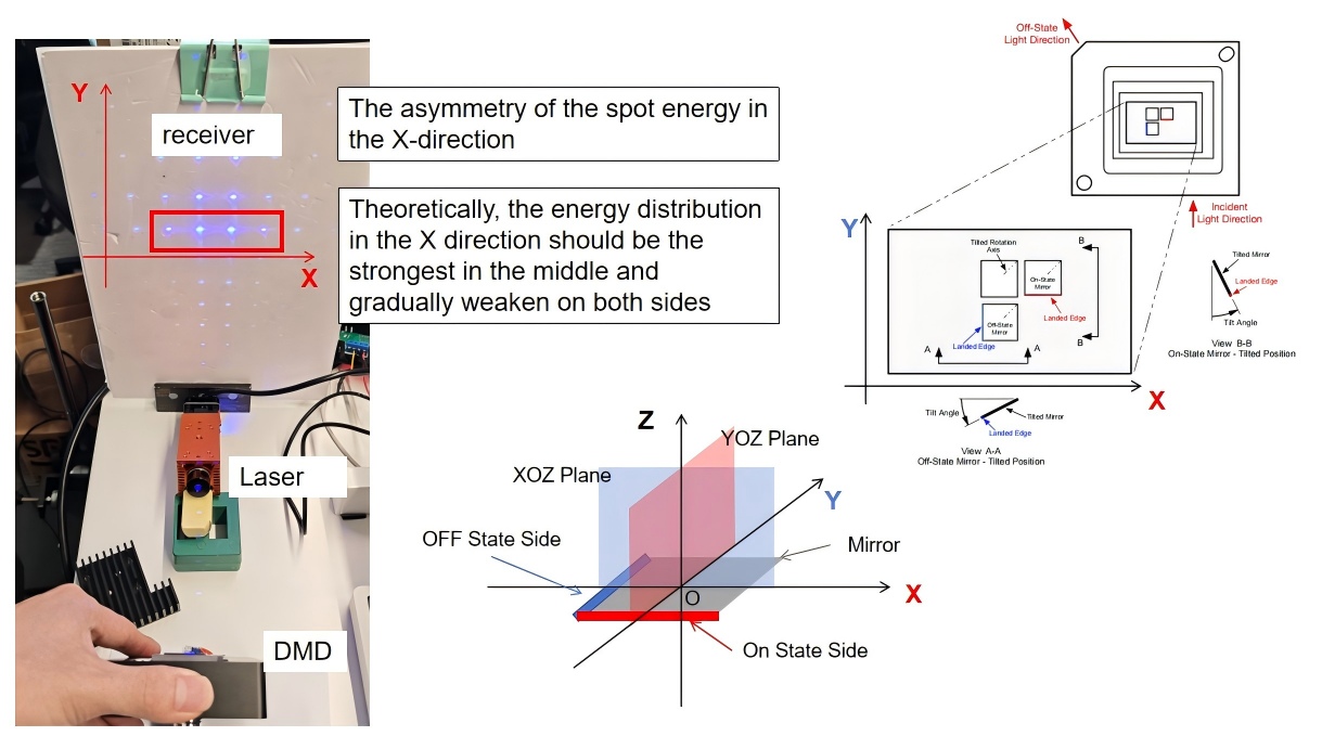

Currently working with DLP670s, I'm reaching for your help as I don't understand what I observe with my optical setup.
We set the DMD to Video Mode and used the Solid Field in the Internal Test Pattern. When we projected a blue laser onto the DMD and observed the reflected light spot, we found that there was an obvious energy shift along the long edge of the DMD, and the intensity of the diffraction spot was abnormal. In the current working mode, all micromirrors of the DMD should tilt towards the long edge direction. Theoretically, the energy distribution in the X-direction (corresponding to the long edge direction of the DMD) should be the strongest in the middle, gradually weakening on both sides, and the energy intensity should be symmetric about the center.
To rule out the influence of the incident light and the placement angle of the DMD, we rotated the DMD along the long edge direction. At this time, the light spot on the receiving screen moved horizontally, but the relative brightness relationship between the spots did not change significantly, and the spot distribution along the long edge of the DMD still showed obvious asymmetry. We have attached a video recording of this phenomenon.
Our analysis suggests that this may be because the micromirrors of the DLP670S switch between On and Off states along two adjacent right-angled edges. In the ideal On state, the surface normal of the micromirror should lie in the YOZ plane, with a 17.5° tilt from the Z-axis. However, due to mechanical structure errors and frequent switching, there is generally a small angle (0~1 degree) between the mirror normal and the XOZ plane.
We are eager to know: Is our analysis correct that the micromirrors of DLP670S and DLP4710 have a slight angle tilt towards the Off state side when in the On state? Could this be the reason why the distribution of the diffraction spot in the X-direction is inconsistent with the theoretical situation? Is this phenomenon common?

  • Hello Zeb,
    Your analysis seems sound.  How far away is the screen from the DMD?  Or stated another way, what is the angle between the orders in the picture?
    Also since the energy seems to be almost equally split along the x direction, which of the two brightest dots represents the "middle"?  If you turn off the DMD the brightest order should be the 0th order.
    Fizix

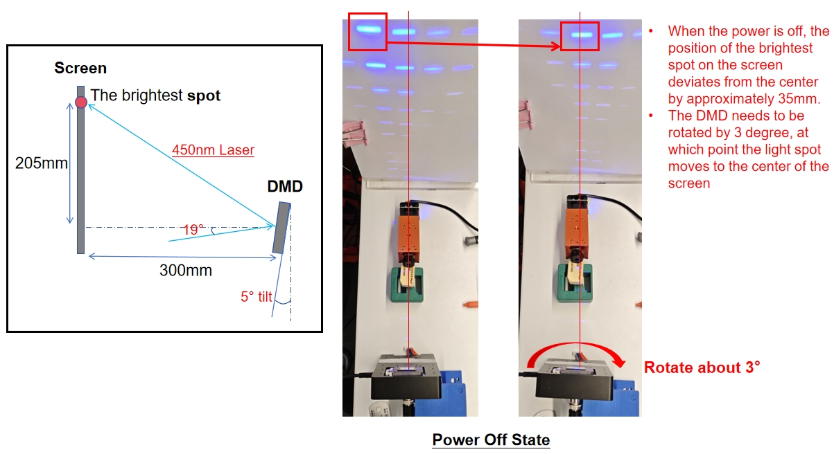

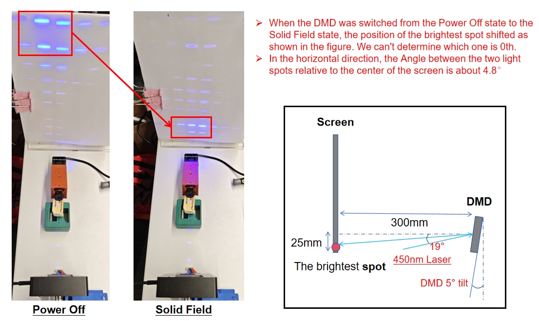

  • Thank you for your reply. At your suggestion, we supplemented the experiment again to compare the diffraction spots of DMD in the two states of Power Off and Solid Field. However, some unusual phenomena were found:
    1. In the Power Off state, the micromirror itself does not seem to be in a horizontal state with the base, and there is a certain angular deviation, causing the light spot in the long side direction of the screen to shift.
    2. When switching between the two states of Power Off and Solid Field, it can be clearly observed that the brightest light spots have undergone considerable positional shifts in the X direction.
    The above phenomenon makes it impossible for me to confirm the specific position of the 0th light spot, but it is certain that when the two states are switched, the tilt angles of the micromirror in both orthogonal directions have changed simultaneously.
    The following two pictures show the relevant parameter information of our experiment. Due to limited conditions, there are certain errors in the measured data. We hope it can help you analyze the causes. We are very curious about what the specific posture of the micromirror is in the Power Off state?

  • I was able to talk to the Optics team today.  Before we give an answer, I have one more question.  In the Image above of Power Off, which direction does the energy move if you turn all the mirrors off?  To the left or to the right?
  • Hello Fizix
    Thank you for your continuous attention to this issue. I'm not sure if your question is understood in this way correctly: When powered on, if the entire micro-mirror is set to Off, that is, in the case of a completely black image, what is the direction of the light spot's movement at this time?
    When powered on, the micromirror is placed in the Off state representing the black pixel. At this time, the energy of the diffraction spot will shift to the right by a considerable distance, which is opposite to the direction of shift when it is in the Power Off state (When the DMD is not connected to the power supply).
    Zeb
  • Hello again Zeb,
    You understood the question perfectly.  Thank you for the answer.  In your image of the "Solid Field" I then say that the order to the left out of the two is the zero order line.  It appears that the mirrors have become slightly torqued to the right (toward the "off" position).
    When was this unit purchased?  Did it look this way from the very beginning or did this develop slowly?  Do you operate it with the the mirrors in the "off" (black screen) for long periods of time?
    Also, in your later pictures what is causing the spots to be long rectangles?
    Fizix

    3. The change in the shape of the light spot in the previous and subsequent pictures is merely due to our adjustment of the laser's focusing, increasing the size of the light spot and forming a long horizontal light spot. This is to make the phenomenon more obvious when taking photos.

  • Hello Zeb,
    Thank you for your explanation.  It is much clearer now.
    By "small lens diaphragm" I am assuming you mean a small numerical aperture (NA) / large f#.  Small NA systems will make any non-uniformities in tilt and pixel topography very obvious.
