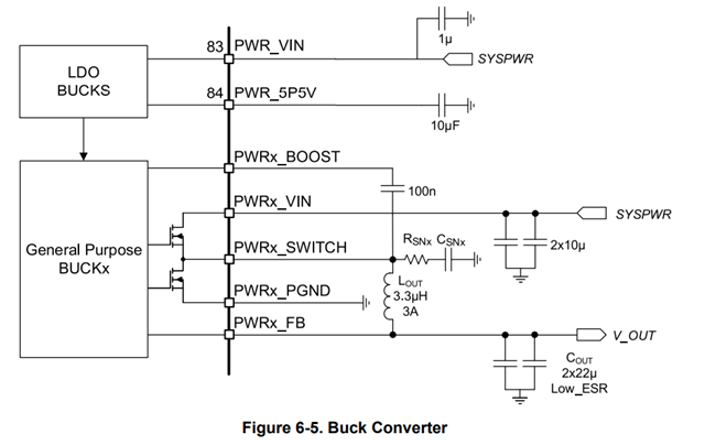

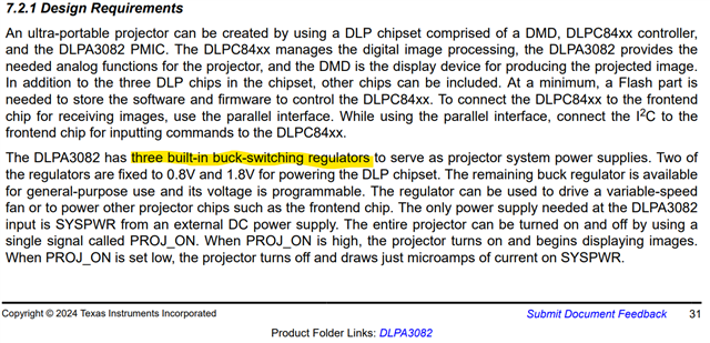

The DLPC3082 has three built-in buck-switching regulators, one of which has a fixed 0.8V output for DLP chipset core power. Could you please provide information on the internal resistor value of feedback divider network(ex: R1&R2) and the reference voltage(VREF)? Thank you.

    Just for clarification you are referring to the buck-switching regulators mentioned here in the DLPA3082 datasheet?

  • Hello User,
    Feedback from the hardware team is that we do not provide internal resistors or values.
    The remaining general purpose buck regulator setup can be seen as follows from figure 6-5 in the DLPA3082 datasheet with all the necessary peripheral circuitry.
