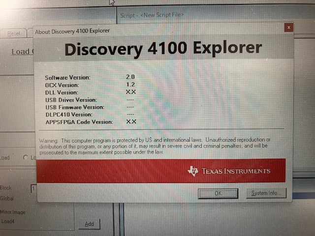

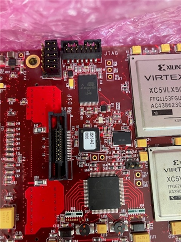

  • Sorry for the delayed response; it is currently the summer holiday season in Japan.
    I am attaching a screenshot of the "About" screen from the DLPC410 GUI. It seems that the version number of the DLPC410 is displayed as a dash.
    I have also attached a photo of the PROM. Could you please let me know if anything can be identified from this number?

  • Kazuhiko-san,
    Your about screen indicates that the GUI does not recognize that there is a board attached.
    Could you also please take a picture of the board (same side) as the one above.

  • Hello Fizix-san,
    I would like to share with you the reply I received directly from the Japanese distributor:
    - The Discovery 4100 Explorer has not been updated for a long time, and according to the company’s internal rules, due to security concerns, they are no longer allowed to run that software.
    - By checking the numbers on the seal of the PROM, no further information is required.
    I sincerely apologize, but I am caught in the middle between you and the Japanese distributor, and I honestly do not know what else I can do at this point. I am at a loss.
