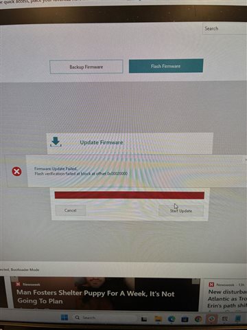

  • Also when I upload the firmware it will fail the first time with error code"Flash verification failed at block at offset 0x00020000"
    But it will succeed the second time.

    When programming, the jumper is moved to J9 and the GUI identified it as Bootloader mode.
    while uploading, it shows error code “Flash verification failed at block at offset 0x00020000" for the first try always, but if try again it says it is successful in GUI.
    After this we cannot operate normally after move the jumper to J67. The D17(LED right next to D6) flashes 3 seconds as the manual says it should do, but we see no logo displayed. This is with the 472TEEVM firmware.
    if using the correct 471TEEVM firmware, I didn’t even see the 3second flashing.
    The GUI will show the system is in display mode for a seconds and then will jump back to booltloder mode.

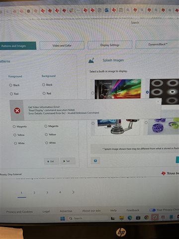

    The splash image display, I assume you mean the display splash image in GUI, doesn't work, with the error message "0x2: invalid or unknown message". This is with the 472TE firmware, which is so far the only software can put the device, even for short time, into the display external mode.
    We also saw the following error message while loading the firmware. If you try again, it will succeed. But first time it shows this every time you upload a new firmware.

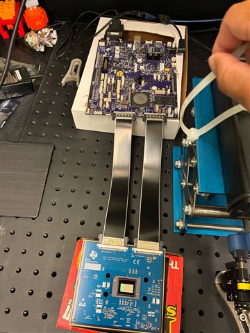

    Can you please confirm the DMD you are using? It would be good to provide a picture of the set up you have.

    We are using  the 471TE.
    Please see the debug log and image. I do believe everything is setup correctly as the manual indicates.

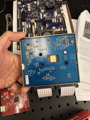

    Meanwhile, can you please provide the picture of the back of the DMD showing the part number?

    Here's a picture of the back of the DMD. We are trying the boot loader but it doesn't seem to work.

    The picture you shared for the back of the DMD is not too clear. I saw it is DLP650TEA0FYP instead of DLP471TEA0FYN. Can you please confirm it?
    Each DMD has its own flash image flash to make it work properly.
    Lori
  • yes, it is DLP650TEA0FYP.  So that means the firmware is not accurate from the beginning I suppose? We did in fact order the 471TEEVM as per the invoice/receipt
  • Hi Ziqi,
    Yes, you were using the incorrect flash image file to program the board. Please use the DLP650TE image file in the attachment and reprogram it. https://e2e.ti.com/cfs-file/__key/communityserver-discussions-components-files/94/Flash_5F00_DLPC7540_5F00_DLP650TE_5F00_LED_5F00_v5.2.0.A.3.0.img
