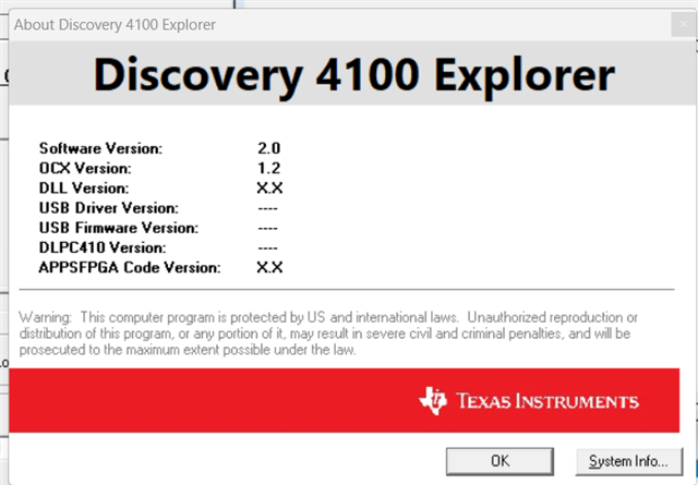

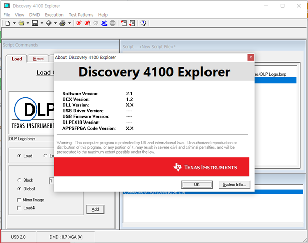

    Can you try running the Help/About and report the versions it shows there.
    Mine is not showing board information because I do not have an EVM plugged in.
    Fizix
  • I don't think mine shows anything as well.
  • ChatGPT tells me that my FPGA is empty so it recommends the step below. Do you think this is a good solution? I am new to this H/W setup so I am not that much expert to this. Could you also give me some advice?
