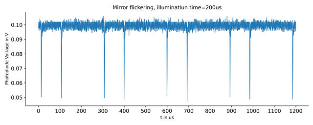

I am right now working with a DLP650LNIR for my master thesis. Because we want to use the DMD later to influency atoms in a MOT, we want the output to be as stable as possible. I realised, when looking at the DMD output with a photodiode, that there seems to be a flickering effect for the mirrors dependent on the illumination/picture time. I think this is to prevent the mirrors from getting stuck in one position, when a picture is portrayed for a long time. For our use, the DMD will just be active for around 1 minute. So this setting should be disabled, but I'm not sure if thats possible with the API or the hardware settings.
Here is a picture for reference:

    I would say please disable the watchdog timer, but the interval you are showing is much too short for the watchdog timer.
    Can you share the script you are using to display your pattern?  I am not sure what is driving this.

    For the Plot in the earlier post, I set the illumination time to 200us (so that the flickering motion can be seen several times).
    For illuminationtime=10**7, i get this image:
    the dip should be from the watchdog timer, or? I am aswell wondering, why there are two dips in the Voltage when the mirrors refresh, and not just one.
    How exactly do I turn the watchdogtimer off?
