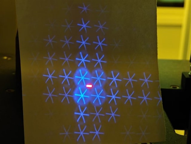

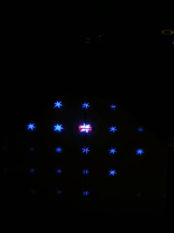

The DLP 9500 product(Vialux V-9501 UV) is suitable for the laser band from 363 to 420nm, but I use the 355nm and 405nm wavelength lasers at a 24° angle, the brightest reflected spot appears in the center, it works fine, but with the same angle of 380nm laser, its reflection angle changes a lot, and the main order spot disappears, I want to know what causes this phenomenon and how we can avoid this problem.
380nm laser irradiation
355nm laser irradiation
  • Hello Wuji,
    This is the result of diffraction due to the interaction of the pixel pitch and the wavelength.  Please see this App Note:  https://www.ti.com/lit/wp/dlpa037a/dlpa037a.pdf
    It looks like at 380 nm the system is in a nearly perfect "anti-blaze" condition.

  • Thank you for your answer, but the result of the 380nm wavelength seems to be too perfect to meet the half-wave condition, and the 380nm wavelength is also within the suitable band of the DLP 9500, so I think the design of the DLP9500 may take into account the 380nm wavelength and adapt it, maybe there are other reasons
  • Hello Wuji,
    Within the wavelength range there are several blaze and anti-blaze conditions as you go from 363nm to 420nm.  I have been doing diffraction studies for a long time and the images show classic diffraction patterns for blaze (355nm) and near anti-blaze (380nm).
    The range only inidacates the range for which the AR coatings are suitable.
