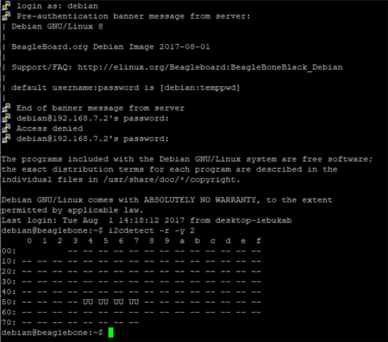

I have a DLPDLCR2000EVM connected with a BeagleBone Black. According to  [FAQ] DLPDLCR2000EVM: Quick-Start Tutorial and Start EVM first, I can detect the EEPROM only on the BeagleBone Black. The 0x1b is not detected.

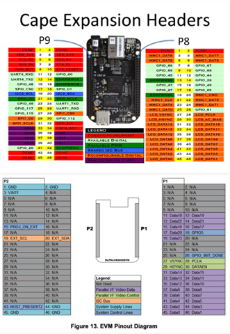

My connections:
The BeagleBone Black is powered by a mini USB to my PC. I control it via Putty. The Debian is bone-debian-8.9-lxqt-4gb-armhf-2017-08-01-4gb.img, which is recommended in the tutorial.
The EVM is powered by an external 5V3A to the J2 connector. The other pins are connected to the BeagleBone Black.

- I have also tried connecting P2_6 to J3 for power, but the I2C connection is not detected.

  • I solved the I2C connection by a cape overlay.
    echo DLPDLCR2000 | sudo tee /sys/devices/platform/bone_capemgr/slots

    i2cdetect -r -y 2

    debian@beaglebone:/opt/scripts/device/bone/capes/DLPDLCR2000$ i2cdetect -r -y 2
         0  1  2  3  4  5  6  7  8  9  a  b  c  d  e  f
    00:          -- -- -- -- -- -- -- -- -- -- -- -- --
    10: -- -- -- -- -- -- -- -- -- -- -- 1b -- -- -- --
    20: -- -- -- -- -- -- -- -- -- -- -- -- -- -- -- --
    30: -- -- -- -- -- -- -- -- -- -- -- -- -- -- -- --
    40: -- -- -- -- -- -- -- -- -- -- -- -- -- -- -- --
    50: -- -- -- -- UU UU UU UU -- -- -- -- -- -- -- --
    60: -- -- -- -- -- -- -- -- -- -- -- -- -- -- -- --
    70: -- -- -- -- -- -- -- --
