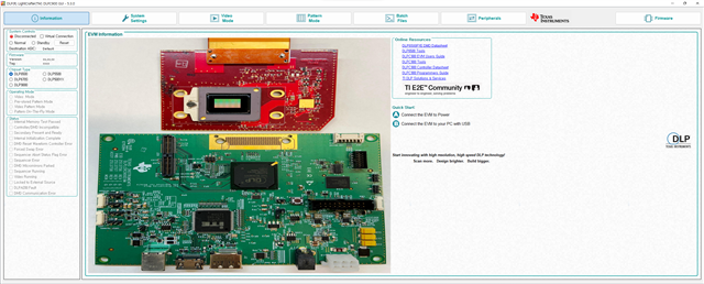

Our lab has been used DLPLCRC900DEVM and DLPLCR90EVM pair. However, suddenly the Lightcrafter9000 shows disconnected status from few days ago.
What I tried so far is switching cables and PC, J11 capping for bootloader, reinstalling SW and FW.
Mainboard has a good heart beat flashing, and display board shows default pattern when powered on.
The screenshot image of the lightcrafter9000 status display is attached here.
Could you please diagnose the problems?

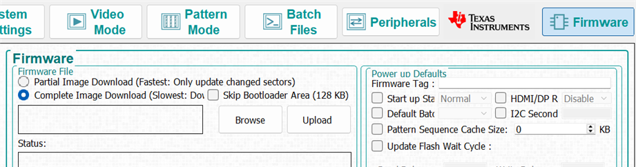

    Since you were able to reprogram by putting the bootHOLD jumper on, then it must be showing "connected" for the reprogramming to work.
    Now try the boothold jumper again except this time set the firmware page as follows:
    Complete image and do NOT skip the bootloader area.

    I am saying that if the system does not connect when the BootHOLD jumper is installed, then the BootLoader is corrupted or the FLASH is damaged.  The first item to try is to use the FTDI UM232H.
    So in answer to the question.  The initial connection showed that everything was working.  But the subsequent connection that did not connect even with the BootHOLD jumper indicates that the bootloader is not working (possibly corrupted).
    Sometimes it is the case that the application is corrupted and will not connect after the application starts.  In that case it will connect when the BootHOLD jumper is installed.  This case allows the firmware to be reloaded over USB.
    In your case it seems the BootLoader is corrupted and requires using JTAG (UM232) to reload.  I have run across this several times.  Usually this restores it.  I have had only one board where the FLASH was defective.
