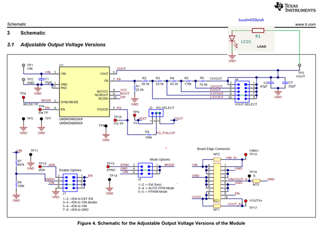

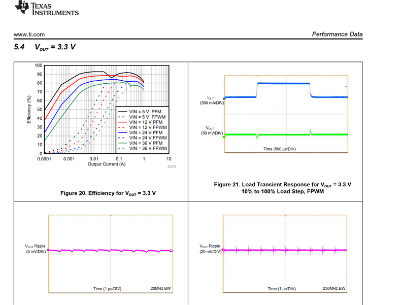

I test evaluation board LMZM23600EVM configuration like in the imagine with efficiency 78%
Costant current Iout 450mA Vout 3,3V

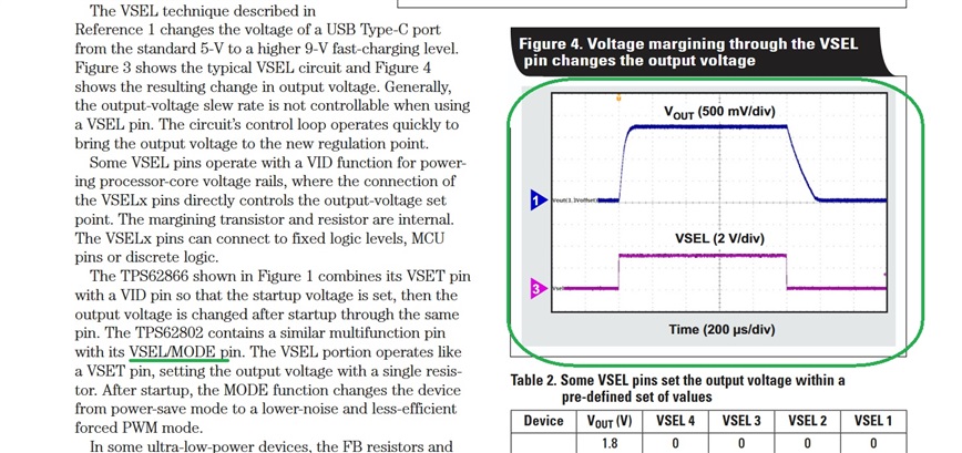

Now, I want to variable output current for led

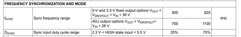

I think about MODE pin 2 at EXTERNAL SYNC with signal square form at DUTY CYCLE variable.  Also for syncro for more board
It should be possible via PWM signal
I test like a table but various duty cycle not various Iout. Why?
Another question : where I can find Vdropout value? I don't find it in the datasheet
