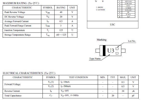

TPS99000S-Q1: Diode change of DMD VRESET regulator schematic
Part Number: TPS99000S-Q1
I refered 'DLP113A_Controller_SCH.pdf' schematic of DLP4620 EVM.
D6 is component of VRESET regulator and MBR0540T1G is applied.
My question is if D6 MBR0450T1G can be replaced by KDR412(KEC) or RB501V-40-AU (Panjit).
-10V VRESET current consumption is not big of my calculation(DMD consumption and photo diode consumption). So I think it can be applied more small package and electrial chracteristic components.
Could you let us know if D6 can be change to those applicants?
below is KDR412
Below is RB501V-40-AU (Panjit).
