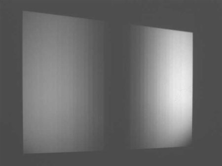

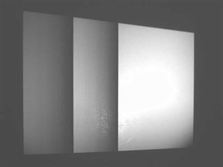

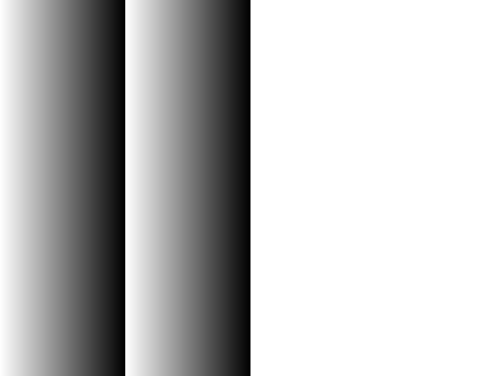

In further testing, I decided to create an image with vertical fringes as follows: The left-most 256 pixels of the image would get assigned decreasing, integer intensity values, from 255 to 0. In other words, the first column of pixels got assigned an intensity of 255, the next was 254, and so on. This pattern was repeated 2 times and the rest of the pixels are "ON" to complete a 1024 x 768 image (as shown in Fig.1). So, starting with this image, known to have a smooth gradient, and integer pixel values, I tried the projection again. I still get the same problem: Inexplicably, the projected image shows discontinuities, or jumps, in intensity levels from left to right in the image.
Fig. 1.
Fig. 2.
The figures I have included here show the problem. For example, see Fig. 2 (One Fringe). The image is supposed to show a fringe with a sinusoidal intensity pattern. Instead, you can see the vertical fringes and the jumps in intensity levels. Note that any line/border you see between intensity levels, in any of these images, is not supposed to be there. All images have smooth gradients, and can be seen perfectly in the computer monitor, or when projected with other projectors.

  • Hello Sanjeev,
    I tried Option 1 in your reply, and the patterns do look smooth.
    Regarding the second part of your reply, I do not understand what you mean when you compare the 8bpp and 24bpp ramp representations. In the images I included in my first post in this thread (Fig 1), I assigned one intensity level for each pixel, increasing the intensity by one as I move from one pixel to the next. In other words, I create the smoothest ramp I can create with 8bpp. Note that the ramp is exactly 256 pixels width, so as to make sure that every projected pixel should have a different intensity level.
    The problem I have is that, when projected, the change in intensity between one pixel and the next is not 1 anymore. Instead, several neighboring pixels share the same intensity level, and the changes between sets of pixels are now larger than 1 intensity level. The result is that the projected ramp image is not smooth anymore, but rather like a staircase. You can see these step changes in Fig 1.

    Ok, that's what I understood you were referring to regarding the bitdepth. But what I don't understand is how can this affect the projected image if it was generated as an 8-bit image? I was expecting to have a smooth ramp using the 256 intensity values possible with 8 bits.
    I generated the ramp pattern using a matrix (768x1024) created in Matlab with values from 255 to 0 (1 intensity level per pixel across horizontal direction). Then I uploaded it to the LC either (1) using the API and bitplanes as said in the following thread
    http://e2e.ti.com/support/dlp__mems_micro-electro-mechanical_systems/f/387/t/113085.aspx#462022
    or (2) using the GUI.
    Here is the image generated.
    Veronica

  • Hi Veronica,
    I tried your image the ramp looks good on my LC kit;  it is not having any discontinuities in the ramp like the one you are seeing.
    I suspect, if you are converting a 24bpp .bmp image into 8bpp bmp image then loading image you would possibly see discontinuities. For example - use the same ramp image you uploaded then using "mspaint"  application save it as 256 colors (8bpp) image notice the saved bmp image itself will have discontinuities.
    One more suggestion is that when you are generating the 24bmp image you can keep data on one channel and keep the remaining two as 0. For example - (255,0,0), (254,0,0),(253,0,0),....(0,0,0), (255,0,0),...etc. After this when importing the image on GUI select 100% of Red channel. Then run this configuration you must see smooth ramp. Similarly while using with API you can mask Green & Blue channel and read only red channel of the image while converting it into raw file format.
