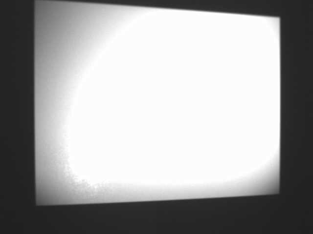

When I use a white image, i.e. all the pixels are “ON”, the captured image reveals a non-uniform behavior of the light coming out from the LightCommander. I have done several tests and consistently got the same behaviour for different frame rates. The projected image is not uniformly illuminated since it has a brightest area and from there the intensity level decreases in a "wavy" fashion. I expected to get approximately the same intensity level on all the pixels.
Is this the expected behaviour? Is there anything I can change/adjust to correct this non-uniformity?

    Here is one image showing the behavior described before. For this image, the projector was placed perpendicular to the projection plane.

  • Sorry... I forgot to attach the image.

  • Hi Veronica,
    It looks like the light beam is out of focus when falling on the DMD. Two things could be possible suspects,  a) problem with one of the element in the optical path is misaligned b) it could be DMD seating on the adapter board is moved. Let me check with optical expert here to find what optical element has to be adjusted.

  • Hi Veronica,
    I got some more details for you.
    Even if the optics and DMD is aligned perfectly there will be 'some' roll-off. A little tweaking in the DMD position can move the brightes spot to the center but will not 100% get rid of the vignetting.
    Couple of suggestion to mitigate this effect.
    1) Reduce the LED current intensity a bit
    2) Adjust the camera iris and/or projection lense until the roll-off effect is diminished.
    Let me know if this is helpful to you.
    Sanjeev

  • Hello Veronica,
    You are correct that the projection lens is designed for a sensor (DX) that is larger than the DMD array.  There is no vignetting from the lens in the final image.
    The issue is not on the projection side, but on the illumination side.  The illumination is approximately shaped like the DMD with some overfill, but there is still 'some' rolloff (you could call this "illumination vignetting").
    Regarding the image that you attached in your message above:
    It is difficult to tell from the image alone what the actual difference in measured intensity is from the center to the edge of your image.  If the illumination shows gross rolloff then one of the optical elements between the illumination module and the DMD are out of alignment.  However, it is very difficlut to elimate all rolloff.
    The effect of rolloff and how you can mitigate the effect depends greatly on the particluar application that you are targeting.
