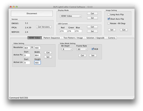

    I am attaching an EDID file with 864x480 resolution. When LightCrafter boots, the DM365 sets the video resolution at 608x684 and bypasses the internal processing that scales the higher resolution to the DMD array. After powering up, set the the video mode to HDMI. On the HDMI tab:
    • set the video resolution to 864x480
    • Active Pix Start=0 and Width=864
    • Active Lin Start=0 and Height=480 and click set.
    • Make sure the Video mode setting is set to 8-bit depth, 60Hz frame Rate and RGB.

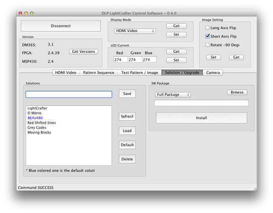

    If you want this to be set on power-up. Click on Solution/Upgrade tab, input a name, and save it. Then click default.  This will execute these settings after power up.
    6237.EDID_LightCrafter_864x480.BIN.zip
  • The forum cutoff my last sentence:
    Attached is the 864x480 EDID. To download it, select SOlution/Upgrade tab. Under SW PAckage select EDID, browse for the uncompressed version of this file and click install. You can switch to the factory EDID by downloading it from the LightCrafter page under DLP3000-C300REFEDID.
