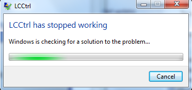

I am trying to set up the LightCommander and going tthrough the steps in the software manual (PN1015703A). However, when I try to run the demos project "LogicLogo", an error message "LCCtrl has stopped working" appears.

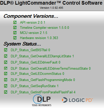

When I go back to check the system status on the splash screen, I noticed the "DLP_status_GetSeqRunState" is "1", which differs from the default value shown in the manual.

    The LC application would run on anything above .NET v3.0 framework. So it is not the problem with .NET framework 4.0.
    I presume you are running this on Windows 7. The windows 7 has security settings which by default don't have write permissions in the root [c:\] drive. So when you are running the LogicLogo demo it is trying to create intermediate files, as the default  Windows permission setting is set to 'read only' it is stopping LCCtrl application.
    Please follow the below steps -
    1. Got to <DriveName>:\ ProgramFiles->DLP® LightCommander™ Control Software folder.
    2. Right Click on the folder and then goto properties window, give full permission (both read and write)
    Now, try running the "LogiLogo" application, it should work.

    I have a completely same problem with Ku. I have followed by Sanjeev's suggestions.
    I changed the install directory to C:\ instead of C:\Program Files, and I added the write permission for DLP LightCommernder Control Software folder.
    However, the problem have not been solved yet. The error dialog still has appeared.
    Have you solved the problem, Ku?
    I have installed it to Windows XP OS as well as Windows 7. But the problem was completely the same.
    Does someone know the similar problems or solution for it?
    Hajime
    I am self reporting the solution of my problem.
    My colleague told me that the problem was occurred by trade mark characters, R and TM in the default install folder name DLP"R" LightCommernder"TM" Control Software.
    I erased "R" and "TM" from the folder name when I re-install the software, the problem was solved.
    I do not know that it is only problem for Japanese version of Windows. But I think that someone would have a similar problem.
    Hajime

    I tried Windows 7 and XP(SP3) 32bit Japanese version.
    Both of them has same problem, the dialog LCCtrl has stopped working was appeared, when I push a start or repeat button on demo mode.
    I have solved the problem on both win 7 and XP by changing a install folder name excluding "R" and "TM" trade mark characters.
    I am happy that this information helps for someone who has a similar problem.
    Hajime
  • Hi Hajime,
    Yes, we acknowledge it is a problem on Japense version of Windows XP and 7.
    Thanks for sharing your work around; there is another way to over come this issue -
    Copy the projects under "Sample" folder For example: C:\Program Files\DLP® LightCommander™ Control Software\Samples\ to a another directory and from there you will be able to browse and run the demo projects.

    Sorry for the late response. Glad to know that you figure out the problem. I am using an English version of Window 7 and I didn't need to update the folder name. But I did need to update all the permission setting for all the folders related to LightCommander Control Software by following Sanjeev's advice.
