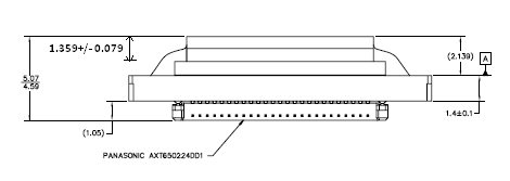

1)  What is the thickness of the coverglass
2)  What is the position of the active array from the top of the package
3)  What is the array tilt tolerance with respect to the mechanical package
  • Hi Chris,
    Please find my answers below,
    1) The window glass thickness is 0.65+/-0.05 mm
    2) I am not clear which surface/ view you are calling 'top' but I have mentioned the distance of the active array from the top (side view) in figure below.
    3) The Micromirror tilt angle variation is specified in DLP3000 datasheet, "Table 4. Optical Parameters". Are you looking for the additional tolerance between the array and package?

  • Hi Divya,
       Thank you for these details.  Yes, I'm looking for additional array to mechanical package tolerances.  I'm assuming the array position (in the side view) is more tightly toleranced to the datum A than it is to the top of the package?   These tolerances will affect our optomechanics design and alignment methodology.   Please contact me offline if you wish to discuss.
