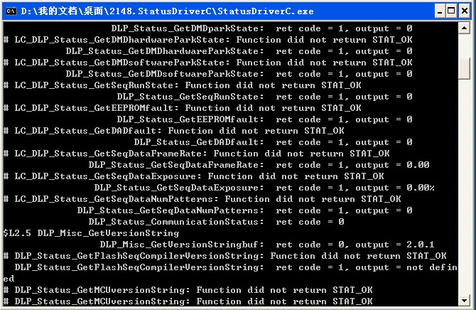

  • Dear Sanjeev,
    Thank you so much for your kind help.
    Actually, we have also met the problem you talked and solved the problem by copy the dll files manually to the correct directory. After that, we can build the project successfully.
    But when we run the project, we cannot get the right return value, see the following picture:
    You can find that almost all the return code is 1, which means the function has not work properly.

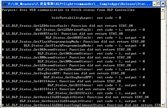

  • Hello Sanjeev,
    I have tried the exe file you attached. And the result is almost the same with mine.
    See the picture:
    Waiting for your response.

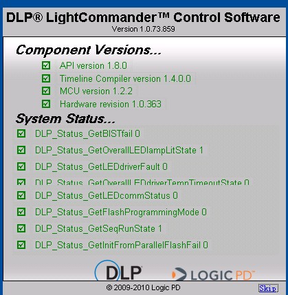

  • Hi Xinyu,
    Ok. Then it is likely the problem with PC side USB driver or PC configuration itself. Can you try installing LC GUI software on another machine and run this application?
    You mentioned that the LC GUI works fine so it confirms there is no issue with LC hardware. Can you send the version information from the LC GUI? In the LC GUI main window goto Help->About LightCommander Control take the snapshot and send it to us.

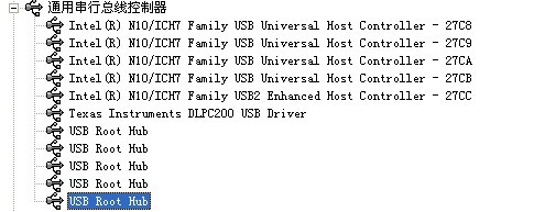

    Also let us know the PC configuration details. Is LC device is detecting properly in DeviceManager? Send the us Device Manager / Universal Serial Bus controllers details/snapshot.

  • Hello Sanjeev,
    Thank you for your suggestion. We are going to find another machine to see what will happen.
    Here is the snapshot of the LC GUI version information:
    And the following picture is the snapshot of the Universal Serial Bus Controller:
    I hope these information could help to figure out what the problem is.

  • Hi Xinyu,
    Now I understand the problem you are facing. The snapshot of LC GUI version is very useful in debugging the issue. Therefore we recommend everybody to put the system version information while reporting the issue.
    The _SampleApps not working because of the MCU Version mismatch. Just upgrade to latest firmware revision, your application works fine. The details provided below.
    Upgrade the LightCommander(TM) firmware from the web. Goto http://www.ti.com/tool/dlpr200 Download DLR200F firmware.
    The LOGIC GUI software is also of older version; you can visit LOGIC website to download GUI software.
    The latest LC GUI and MCU version as follows -
    1) MCU Version 2.1.5
    2) LC GUI 1.0.92.495
    Note - Always ensure you are upgrading DLPCR200F first before upgrading LC GUI.
