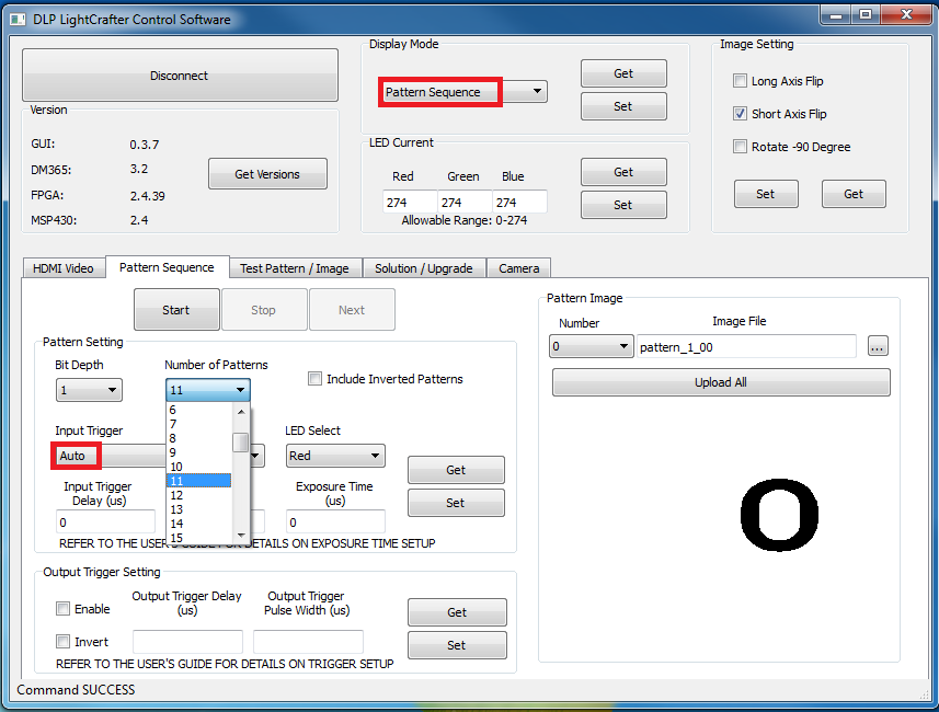

    Hi Daniel,
    Also make sure that you are in 'Auto' trigger mode and selecting the right number of patterns in the GUI as shown in the below image (this will give a 'Command Failure' message if not selected correctly).
    Hope this helps!

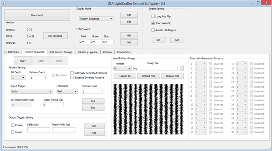

  • Hi Divya,
    I have a similar problem. Static images with 24Bit color depth can be easily loaded and displayed. However, when i tried to load and display pattern sequence,  i get the "Command Failure" error after pressing "Start" button. I tried 608x684 images with 8Bit and 1Bit color depth. My settings are as follows:
    Do you have any idea about this error?
    Emrah
  • This problem occurs after booting the lightcrafter a couple of times. I don't know the actual reason. It works now after being able to save the patterns as a "Solution" once.

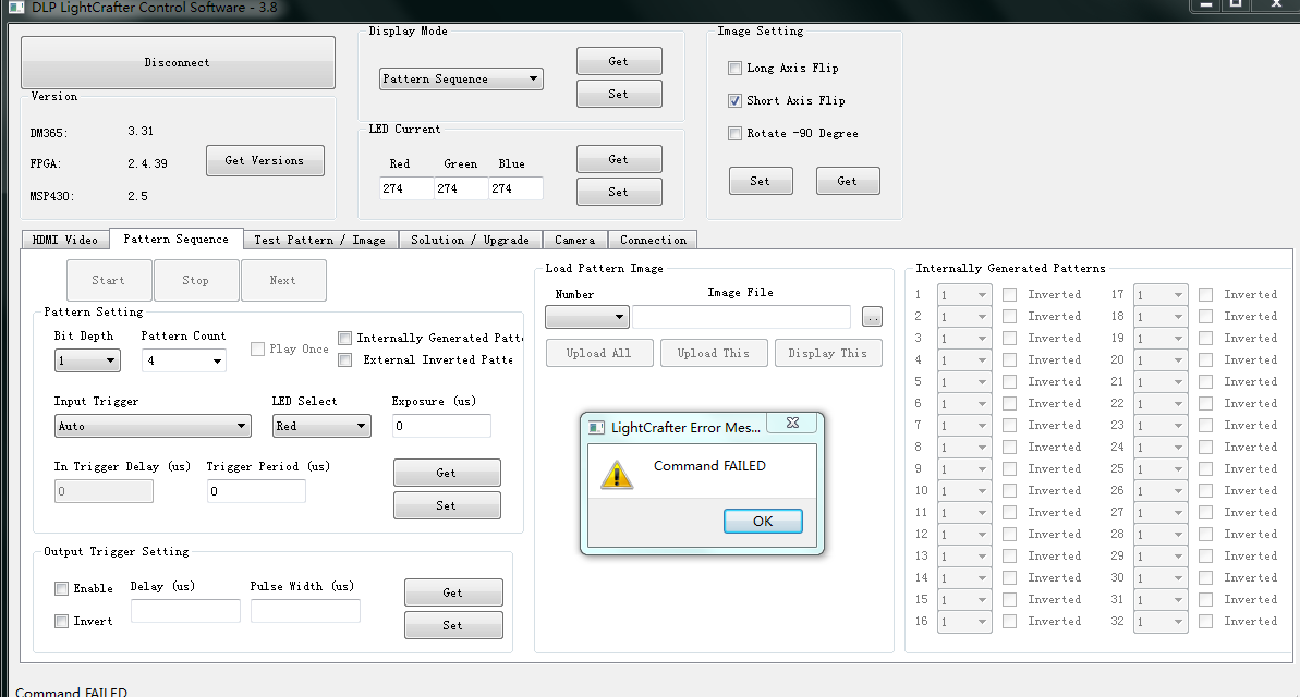

  • Hi Divya,
       I can't upload 4 images, whose bit depth is 1 or 8. I first have set Pattern Sequence, Bit Depth , Pattern Count ,Input Trigger, then upload all, but it doesn't work. Just as the following  figure,  I want to know where the mistake is, Please help me.
  • Hi Dongliang,
    Welcome to DLP & MEMS Section of TI E2E Community!
    Did you load more than 4 patterns before the above sequence? I am asking because there is a known issue in the LightCrafter GUI v3.8.
    The "Command Failed" error pops-up in Pattern Sequence mode when loading less patterns than what was loaded the entire time LightCrafter is "ON", irrelevant
    of the pattern bit-depth. Reboot the LightCrafter and GUI to successfully upload patterns.
    Divya

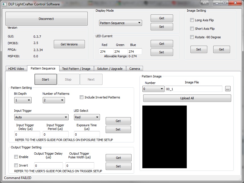

    I cannot get my 1-bit patterns to upload to the device in pattern sequence mode.  I get a command FAILED message every time.  If I use "Display This"  I get a garbage image on the wrong led.
    Here are my settings:
  • Morgan,
    Welcome to the DLP & MEMS E2E forum.
    Is this your screen capture? Do you see an LED color other than red? Did you press "Set" before trying the "Display This"?
    Have you verified your image properties? Right click on the  xxx.bmp file; select "Properties"; select the "Details" tab. Make sure:
    Dimensions 608 x 684
    Width 608 pixels
    Height 684 pixels
    Bit Depth 1
    Also make sure that the number of patterns which you select matches the number you specified in the "Pattern Count" box.
