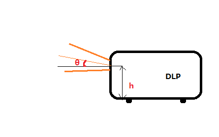

  • Hi Pascal
    Thank you for your prompt reply.
    Sorry for my question being unclear,  I've attached a simple illustration of the dimensions I'm looking for.
    Also, may I know the wavelengths of the R,G and B LEDs?
    Thanks.
    Sze Ping

  • EDIT:
    The dimension given on the slide which was attached here is incorrect. I have gotten the correct value.
    The center of the array to the center of the projection lens is 5.4 mm.
    I apologize for the error.
    Pascal
    Sze Ping,
    Perhaps this slide will help with your question about the DMD offset.
    B. R.
    Pascal
  • Thanks Pascal for the slide. I'll be able to figure out "h" on my own.
    Is "theta" 24 degrees as you explained previously? Or is the plane of the mirror array tilted at a different angle?
  • Sze Ping,
    I do not have a measured value for "h", or I would gladly give it to you.
    No, the "theta" in that diagram is not the same as the illumination angle. I don't know exactly what the "theta" angle is. It would require knowing the distance of the nodal point of your lens from the DMD. The LightCommander is designed for the use of Nikon F-mount lenses. I will try to find the nodal point distance, and calculate the "theta".
    The DMD offset from the center of the lens optical axis has nothing at all to do with the illumination angle required for the DMD which I discussed earlier. That 24 degrees offset is the ray bundle offset required to illuminate the mirrors in order to assure that the "on" mirrors reflect the rays perpendicular to the DMD surface (plane of the mirror array). This allows the projection lens to look straight down on the plane of the DMD.
    On the other hand, the DMD offset shown in the diagram is for the purpose of raising the project image of the DMD above the horizontal, so that the LightCommander can be set on a table, and the image will not be cut off by the table in front of it. This is a common, if not universal, practice in projectors meant for table or ceiling mount. Some customers who are developing non-projector applications with the LightCommander would prefer to have the DMD centered in the lens circle, rather than offset. But, it is designed as it is - in projector style.
    I will try to find a number for the "theta".
    Pascal
  • Sze Ping,
    I removed the drawing I posted earlier. It had the wrong dimension on it for the DMD offset (center of DMD array to lens axis). I posted a new value of 5.4 mm, but I am still trying to confirm that measurement.
    The angle "theta" will depend on the rear nodal point of whatever lens is used. Unfortunately, Nikon does not publish this value for their lenses, so I don't have an actual number to give you.
    Pascal
