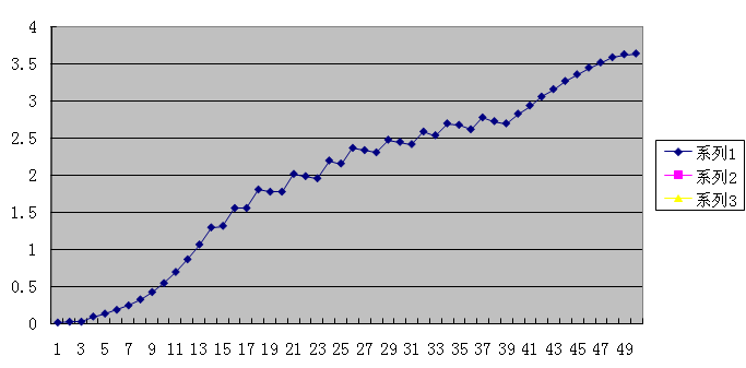

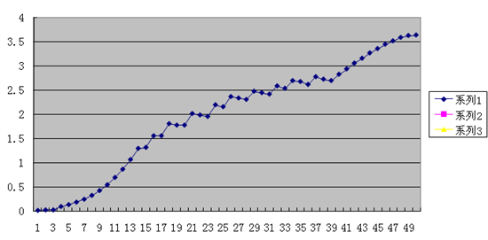

we input linear intensity to the DLP Lightcrafter ,and use a photometer to measure the intensity that the DLP Lightcrafter  projected. the result as shown in following picture. why the intensity of the DLP Lightcrafer so instability?

    About the light curve - could you give me more detail as to how you set up the LightCrafter? What is the x-axis?
