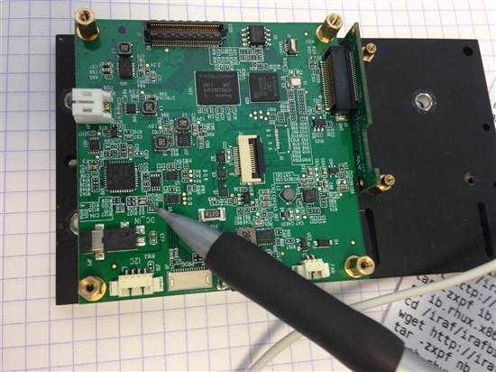

  • I bought 2 DLP a year ago for optical system development.
    One of them is not working anymore. When plugging it to power, a green light flash on the bottom stage occurs then a red one.
    So I tried as above to measure check point voltage. I found 1.8V and 1.0V but then I measured 0.44V on the 3.3V point and 0.8 on the 2.5V.
    I also noticed that the board warms up to a very hot temperature. So I took back the power instead of burning out the board.
    Any suggestion ?
    Thanking you in advance.
    Obi
  • Obi,
    Sounds like something shorted, or failed in a high current mode. I can't say what. Could you say a little more about the LED you mentioned. Is it one of the annunciator LEDs on the board? Can you say more precisely where it is on the board? How long does it stay green? Does it alternate between red and green?
    Like you, I am concerned that letting it run while drawing too much current could burn up the board. Can you measure the amount of current being drawn?
  • Hi Pascal !
    Thank you for your answer. Here is a snap of the LEDs that flashes when plugging the power cable (see the tip of the pen below). The green led switches on for less than one second, then the red one blinks each one second approximately.
    How can I measure the current being drawn ? Right after the power cable ? Is that what you mean ?
    Does it help ?
    Thank you.
