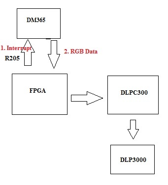

  • Hi Di,
    Please find my answers below,
    You mean, if the incoming data from HDMI, it's in External Sequence Mode, and if the incoming data from DM365, in Internal or Extended pattern sequence mode?
    Yes, if the incoming data is from HDMI, it's in External Sequence Mode. DM365 accepts input from rest of the interfaces (USB, SD, NAND, UART, DDR2 and Camera). In Internal pattern sequence mode, the data is pre-loaded in mDDR (for 1-8 bit monochrome patterns).
    Extended pattern sequence mode is a special case where DM365 configures the FPGA for this mode. FPGA then sends interrupt to DM365 asking for data as shown below,
    pardon my drawing skills.
    Divya
