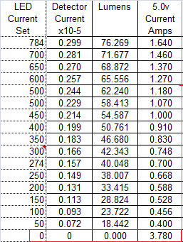

    We have measured the LED currents indirectly by passing the light through integrated sphere and connecting a detector to measure the value.
    Below are the measurements taken from one of the LightCrafter units, LED Current Set is the GUI setting, Detector current is measured value from the detector and 5.0v Current is the 5V input supply
    As you can see, the high current draw at a setting of '0' is causing LED driver anode voltage oscillations. It is highly recommended not to set the LED current value to '0'.
